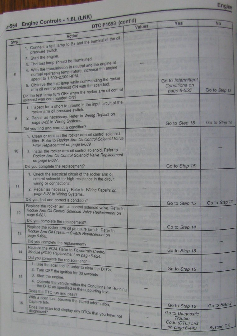

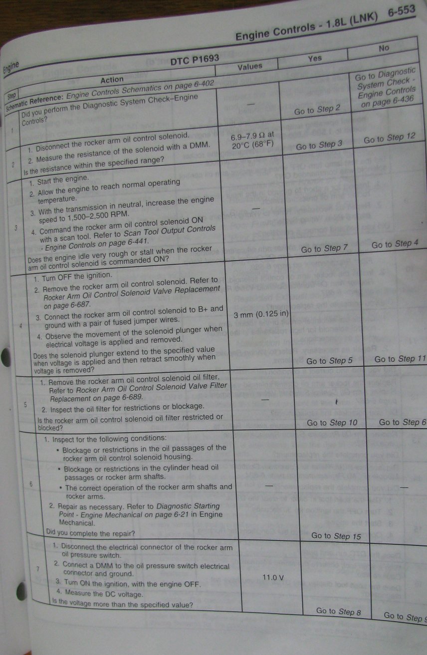

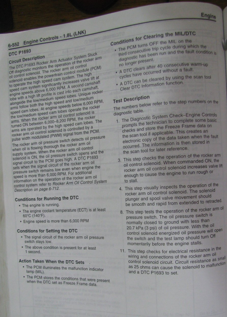

attached are the three pages from the book for P1693
readable, but not the best quality
