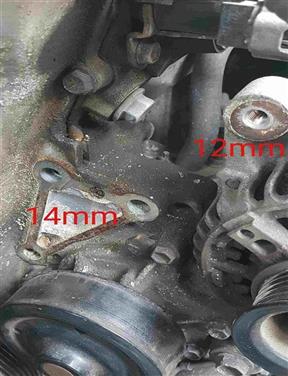

• Undo the 12mm NUT holding the hydraulic onto the back of the engine. (See Image 1)
o I also removed the 10mm bolt holding the power steering lines to the fender and then used a bungee cord to pull them up a bit. This made just enough room to get the top of the drill in level. (See Image 1)

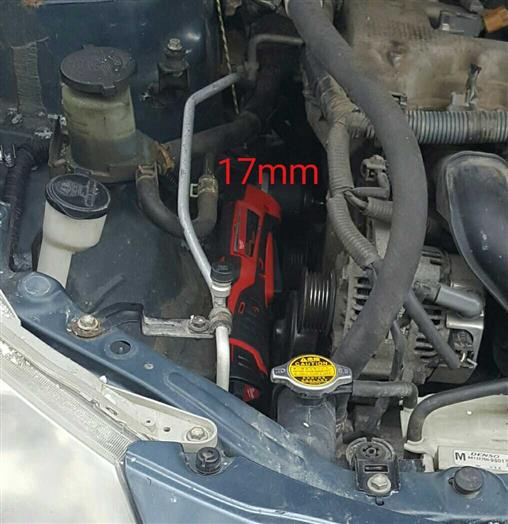

• Undo the 17mm bolt holding the tensioner assembly to the engine down amongst the pulls. Highly recommend a long ratcheting wrench for this to save time and aggravation. (See Image 2…Drill is in place where the belt tensioner & bolt would be had it not broke)

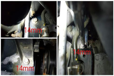

Step 3) Unbolt passenger side engine mount and wiggle it out.
• Three 14mm bolts hold this onto the chassis. (See Images 3)

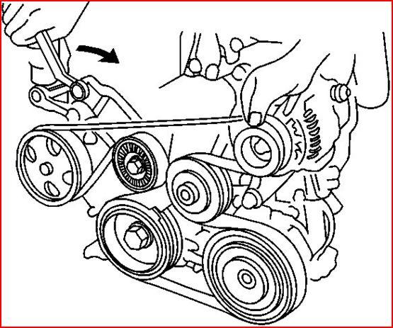

• One 12mm bolt holds this to the alternator (See Image 4)
• Three 14mm bolt hold this to the block (See Image 4)

IMAGE 1:
Top Belt Tensioner Bolt & PS Line Bolt
Image 1 Final.jpg (12.97 KiB) Viewed 28634 times
IMAGE 2:
Belt Tensioner and 17mm Bolt Location
Image 2 Final.jpg (45.13 KiB) Viewed 28634 times
IMAGE 3:
Passenger Engine Mount Bolt Locations
Image 3 Final.jpg (24.49 KiB) Viewed 28634 times

IMAGE 4:
Passenger Engine Mount Bolts on Engine
Image 4 Final.jpg (23.35 KiB) Viewed 28634 times
