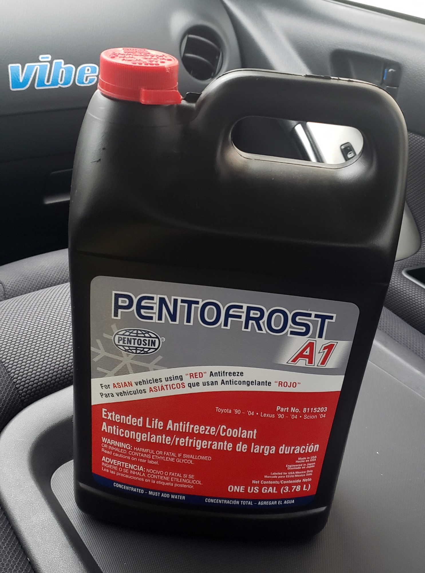

Posts: 8442
Re: Asian concentrate coolant
Yes, that Toyota Red will perfectly fine for SSizler's '03. That's all I've ever ran in the Vibe.
Didn't feel like going to the dealer this time, so...
20200205_171652 - Edited.jpg (553.66 KiB) Viewed 5242 times
Found the Pentosin to be reasonably priced at Advance Auto compared to what I remember paying for the red at the dealer.
