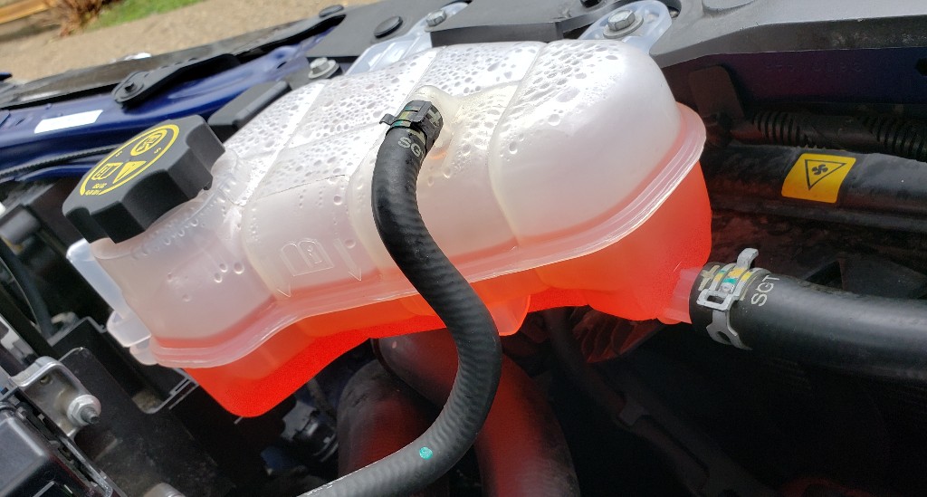

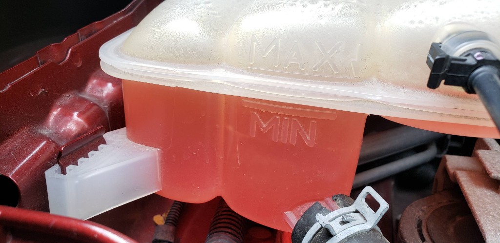

That is true in my experience with the two vehicles we own that have this coolant. The coolant starts out orange, but changes to a reddish/pinkish color over time. From what I gather, that is the result of the dye breaking down after all those heat cycles.
This is the Ford's "Motorcraft Orange" factory fill (which is essentially Dexcool) after almost 5 years.
Here's the Dexcool in my Sonic.
I have zero experience with the Toyota pink coolant, but from what I've seen in the pics the fresh stuff is a different shade than what I've seen Dexcool change into. No idea what that stuff looks like after some age compared to Dexcool.
