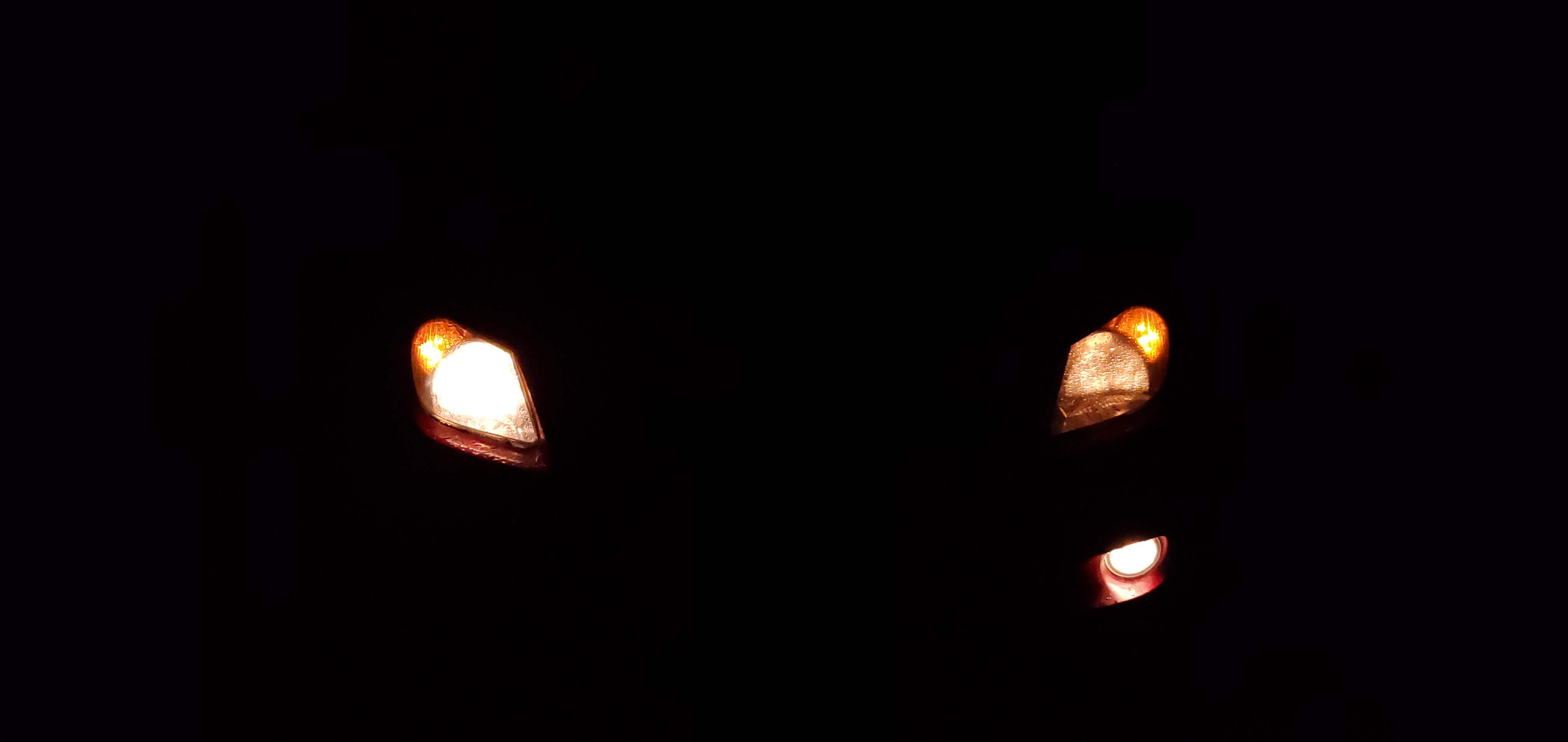

Yeah the headlight housings are clean.. one place had it fixed for a month or two but then it went out again. Like when the light Is on you can barely see it
(Heres a pic, sorry took me awhile to reply I took a break from this)

What bulbs are you running? Perhaps if they are low quality bulbs they are the issue? Or have you tried swapping those around, and confirmed it is indeed the wiring?
Did you solder in a new ceramic connector?

Have you ever ran aftermarket bulbs that were over the OEM recommended wattage? If so, you might have damaged the plug. I had to solder new connectors on both of mine because it basically melted them from higher wattage bulbs. if the connectors look ok use a multimeter and check the voltage at each headlight. If they both show virtually the same voltage, then it's likely the bulb. Have you tried swapping the bulbs with each other? You could also run a temporary ground to the driver side plug to see if that fixes the issue. Keep in mind when if you do that, your DRL will run at full brightness because of how the car controls the DRL.
In a case like this, you have to just start some trial-and-error elimination until you find the problem.

ill try switching them.. im not quite sure what bulbs are in there right now. the bulbs in there now im pretty sure are the ones installed by the mechanic i went to fix the issue. i will need to get a multimeter to check the levels..
