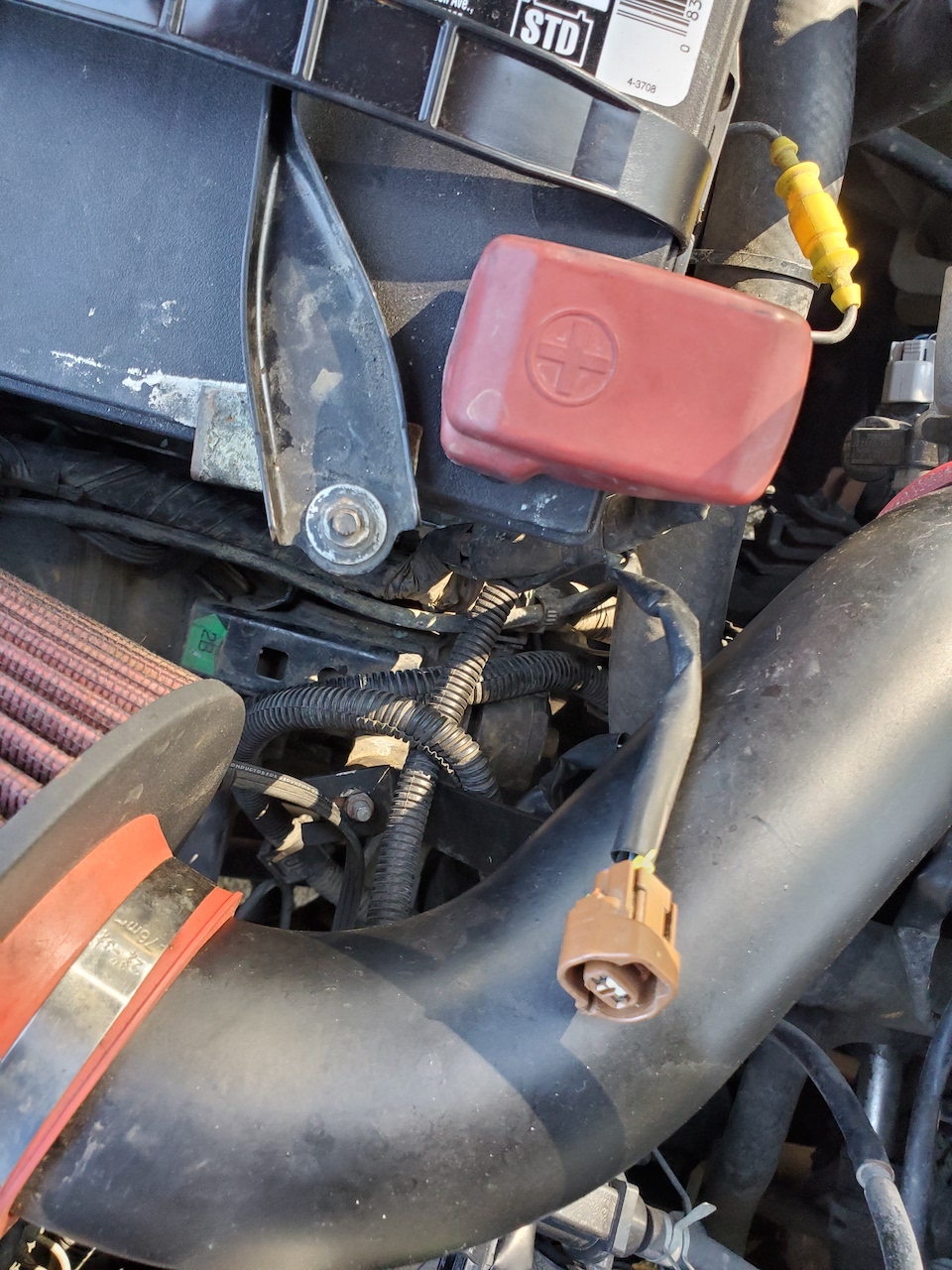

My thought is that the o2 sensor is the root of the problem. The sensor looks very very rusted so, theres a good chance its the original. Anyone else have advice? Also, if anyone is able to look under their hood, can you tell me what the connector that is coming off the harness right after the positive battery terminal is. I can take a picture if needed.

I'm not sure what connector you're referring to. Post a pic if you get a chance.

Re: Misfires and o2 sensor problem
That connector is potentially the source of your P0171 code. I know it is part of the VSV contraptions located closer to the master cylinder.
I will post a pic of my setup when I get home, to show you how the wires are plugged, and the vacuum hoses are routed for the intake.

zbyers wrote: ↑Fri Nov 01, 2019 7:57 am That connector is potentially the source of your P0171 code. I know it is part of the VSV contraptions located closer to the master cylinder.
Please ans thank you! I dont know why someone was jumping it with a pin shoved into it
Any luck on pictures of your setup? Or seeing what that connector plugs into?
