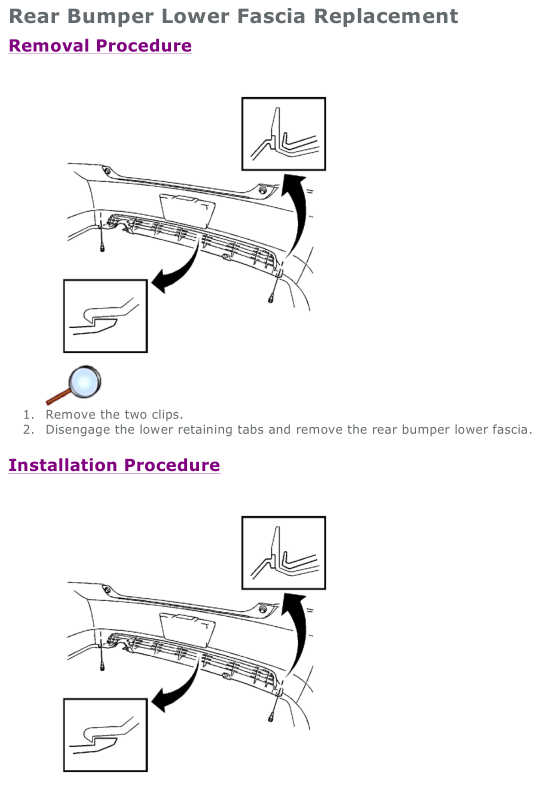

Re: What is this part falling off my rear bumper?
Post by jolt »
Rear bumper lower fascia and there appears to be two different versions. The vented one and the solid one. Your picture looks to be the vented one.
rear bumper lower fascia.jpg (48.37 KiB) Viewed 2431 times
Install info :
1. Position the rear bumper lower fascia to the rear fascia and engage the lower retaining tabs.
2. Install the two clips.
The solid fascia is different mounting then this one and uses two clips and the ten retainers to hold in place.
