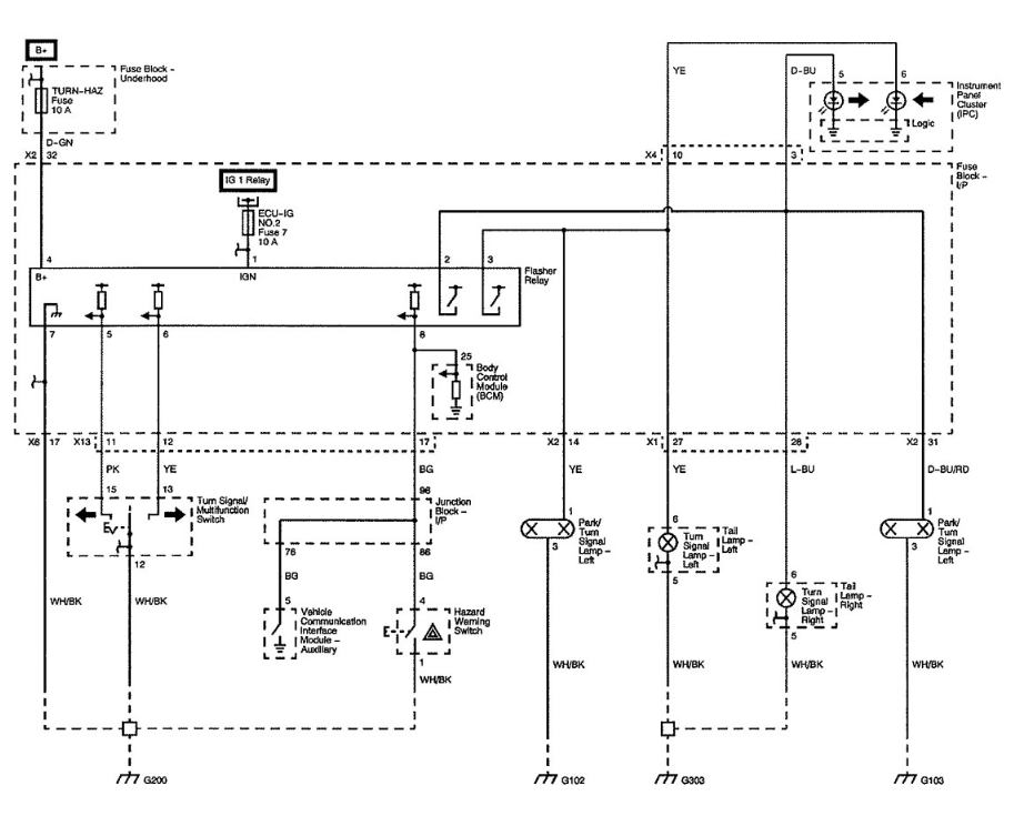

Re: 09 vibe No signals or hazards at all!
I found a wiring diagram for an 09 Vibe turn signal/hazard lights, which is attached. Its not a complicated circuit, but the parts that are common to both the turn signals and the hazard lights are the fuse, the flasher, wiring, and bulbs. sorry to keep harping on it, but when you checked the fuse, did you just look at it, or did you swap it with a known good one or use an ohmmeter?
09 Vibe Turn Signal/Hazard Wiring Diagram

Post by jolt »
Attached are the wiring for a '09 Matrix which matches up with the GM Vibe that joatmon posted. It may be a little easier to follow and I added the connectors with wire pin outs also. Can you hear or feel the flasher clicking on and off when you turn on the turn signal in either direction? This may help determine if the problem is on the input side or the output side of the flasher relay.
