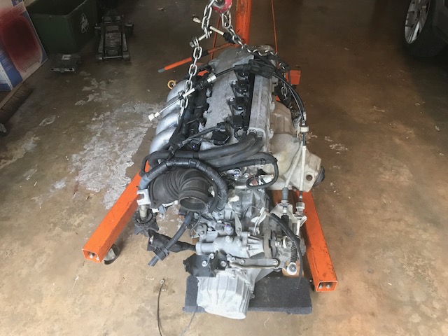

I have a 2003 Vibe GT. The trans is shot. It has 201k on it. The car has new struts, CV axles, etc. I was going for a junkyard trans but I found a local JDM engine and trans (6 speed) for $1800. Other than some hood and roof clearcoat paint problems, everything else works. I'll shoot the roof and hood once it's running again. @$100 for a quart of base and clear from TCPGlobal. I started the swap today and post updates. This is my son's car that I bought a few years ago for $1k and all it needed was a clutch. Lately, it developed a vibration @70mph and as it got worse and after changing the easy stuff, I knew it was the trans. First year GT. I might as well save it. I also have a 2006 base Vibe manual that I bought new after touring the NUMMI plant. The 5 speed went after 140k and I swapped in a 6 speed. I've also rebuilt a 1zz on a 2005 Vibe that I bought cheap to flip. Although I don't feel like I'm "Generation Vibe" (I'm 57), I love these cars. I've done a couple of Nissan Altima 2.5 JDM swaps and I've had to swap intake manifolds. I'll post what this takes.
The JDM motor.  Right off the bat, the shift lever is different.  I'll see what sensors need to be changed when I swap out the harness.

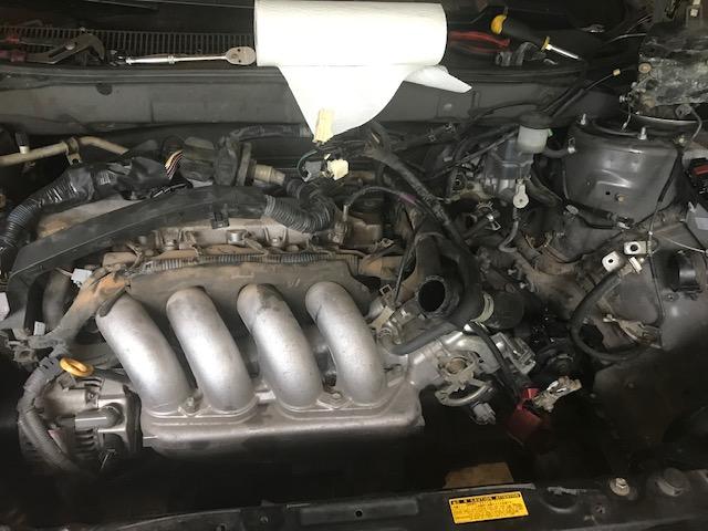

Started pulling the powerplant.  I disconnect the harness from the ECU and pull it out through the firewall.  Makes it easier to see if some sensors don't match up.  The top work is pretty much done.  @ 3hrs work just loafing along and drinking beer. It's 94 degrees amd I ain't as young as I used to be.

The engine and trans are Japanese Domestic Market from https://tennesseejdmmotors.com/ They are supposed to have less than 50k on them. This one looks like it came out of some kind of RH drive car. Celica maybe?
The only differences I've seen so far:
The shifter select lever shaft is different and will swap from my old 6 speed.
The knock sensor is different and must be swapped along with the mounting stud.
The rh engine mount bracket has a different part number. Even though it looks like it will work, I swapped it over. I'm also using all of my old mount brackets because it's easier to do it now.
I'm swapping the throttle body because the the one I received looked slightly damaged at the cable quadrant.
A couple of small brackets, etc., due to rh to lh drive differences.
The rest of my old harness hooked right up. FWIW, I disconnect the harness from the ECU and feed it through the firewall and pull it out with the engine. It's much easier to work with this way.
I'm waiting for a few parts before I install it. I've already installed a new clutch am about done with swap-overs. I'm about 6 hrs into this.
