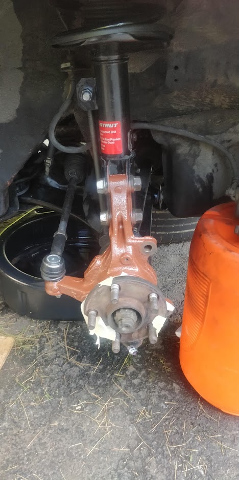

Over the past couple weekends I finally had time to redo the front suspension. It was a pretty easy & straightforward job. I replaced the control arms, balls joints, inner & outer tie rods, strut assemblies, and stabilizer link bars. I went with all Moog parts minus the struts and everything fit great. Ran into trouble with a couple of spots that I'll share for anyone attempting this.
The stabilizer link bar nuts were rusted and impossible to get off so I ended up cutting them with a small angle grinder which made easy work of them. On the driver side control arm the front bolt is too long and is blocked by the transmission pan when trying to take it out. You'll need to temporarily remove the bolts/nuts holding the front motor mount and driver side transmission mount in. Once they're free carefully jack up the transmission with a wood block to give enough clearance for the control arm bolt. I bought Monroe quick struts and when torquing the mounting bolts that attach the strut assembly to the body one of the studs snapped. I was surprised as I went off factory specs. I was able to press the broken stud out with a ball joint press and socket and opted to replace it with a bolt and nut instead. The brake dust shields were rusted to nothing. I opted to remove them and am not going to bother replacing them. The steering knuckles were pretty rusty so while I had everything apart I went ahead and cleaned them up with a wire brush. I then cleaned them and hit them with a couple coats of rustoleom rusty metal primer, then finished them with flat black rustoleom. I also hit the wheel hubs and rotors with rust remover.
After getting everything back together I took the car for a spin and what a world of difference. Before it was clunking and very sloppy. All clunks are gone, the ride is much smoother, and feels much better to drive. Up next I'll be replacing a faulty steering wheel clock spring and throwing some new tires on it. Shouldn't be too much longer before it's ready to pass inspection. Attaching some pictures of the suspension along with this post.
