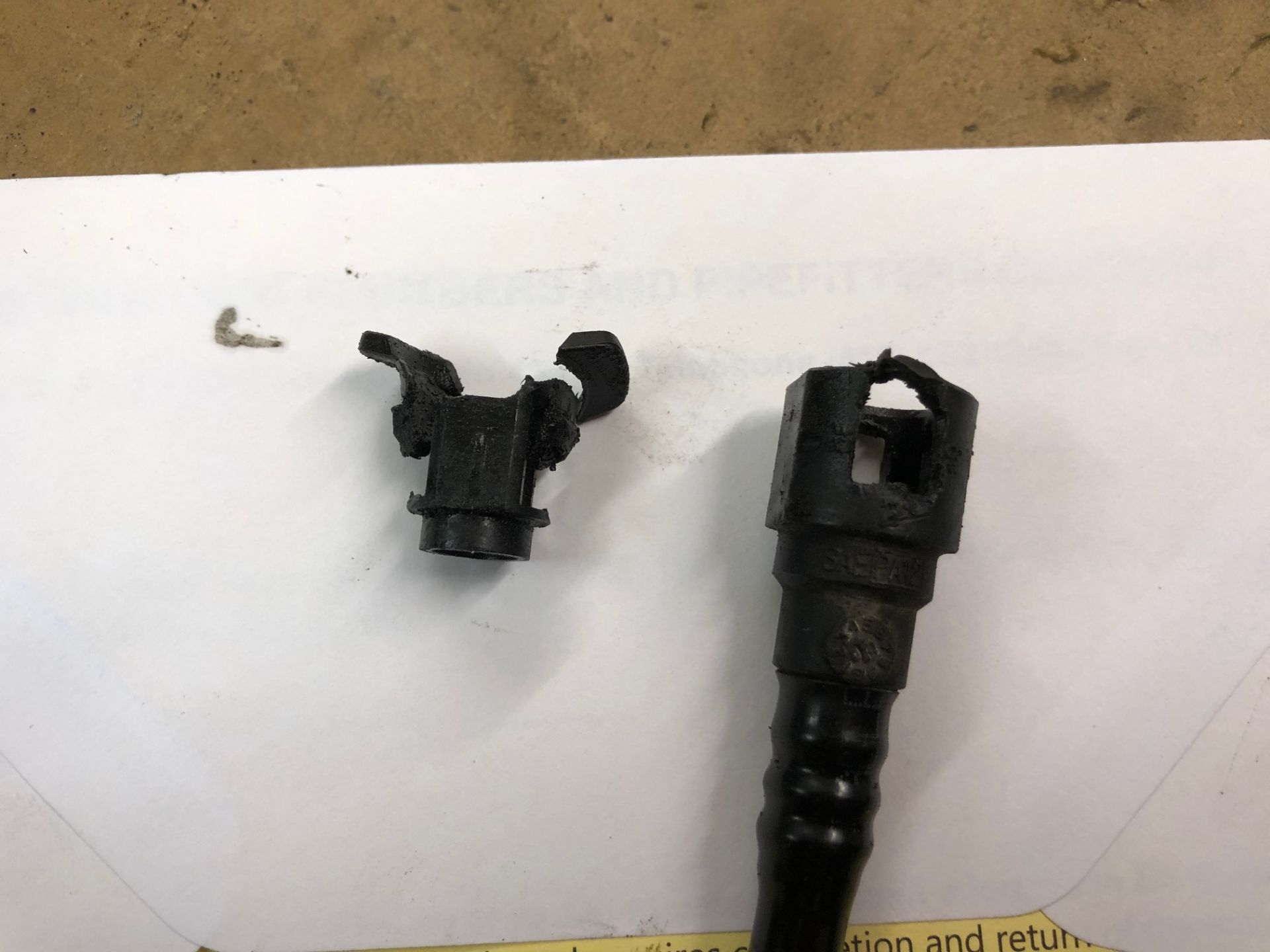

OK, so while I had my Vibe up on the lift, I checked out this "charcoal canister" thingamajig and need to further educate me on it, how it works, and follow a flow path as to what every hose does. Notice the "cracked" plastic tube that I discovered. Not sure what this does or where it goes BUT it may be related to the P2445 code that has been on the car since I took delivery of it 1-1/2 years ago (7000 miles) :o

OK, so I had access to the lift again. Fixed this vent line which runs from the fuel tank check valve, over to the charcoal canister. Not sure if it will help BUT it's now fixed! ;)

While removing the part from underneath the car, there was one fitting that was extremely difficult removing. All pieces were of a plastic material (no rubber or other flexible pieces) and lucky for me it was the piece that was chewed through so it was already separated from the rest of the vehicle. This allowed me to remove it on a bench instead of under the car ... huge advantage. I ended up carefully breaking a corner on each side in order to pull the fitting off. There was barely enough material remaining to reattach it as I damaged it pretty good removing it!
