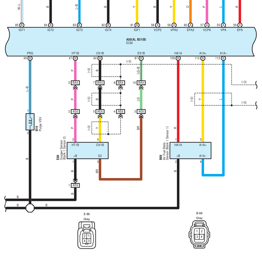

Can anyone provide the pin assignment for the O2 sensor on my 2009 GT. one pin is ground, one is the signal to the computer and two are the heater circuit. I want to check mine out before I buy a new one. Also going to try to clean them first.

Here is the wiring with plugs body for both sensors for the 2ZR-FE engine.
2ZR-FE wiring for air fuel ratio sensor and oxygen sensor.  Related plug body's at bottom of image.
sensors and plugs.jpg (189.79 KiB) Viewed 3822 times

Thank you Just what I needed. I will post my results

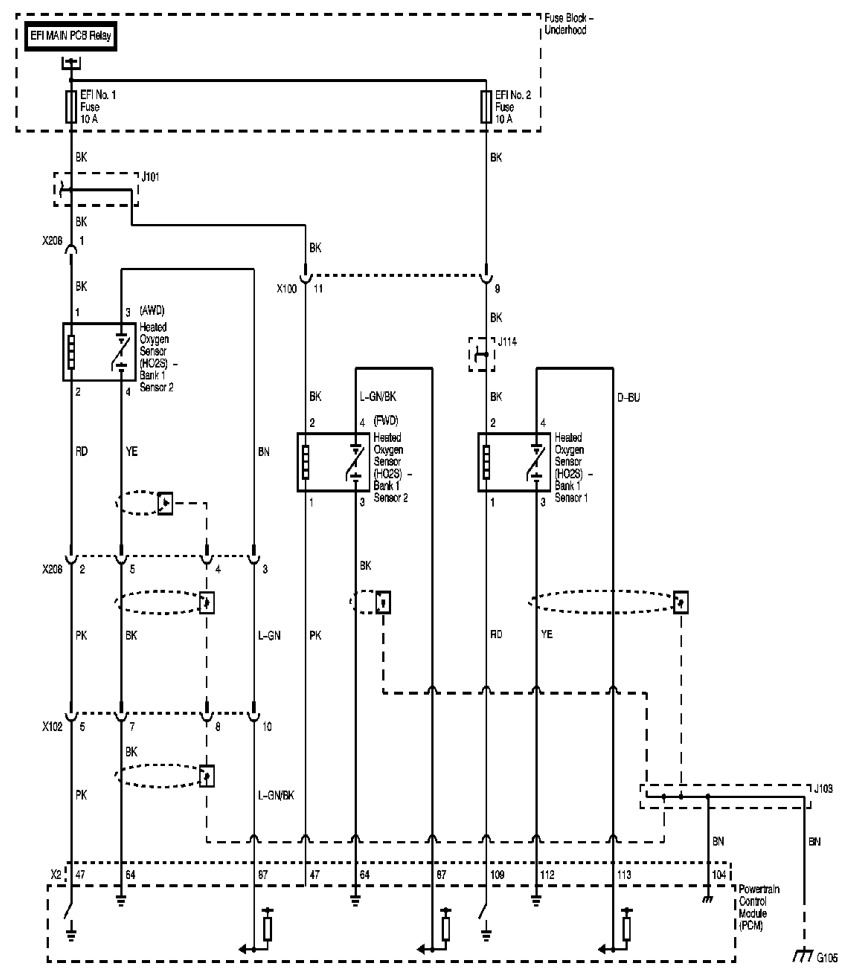

Here is another one. This is what the GM guys get. The first one is from Toyota. Looks like two of the wires colors may be differ but same basic layout only flipped from top to bottom.
GM view of the wiring.
another one.jpg (142.41 KiB) Viewed 3806 times
