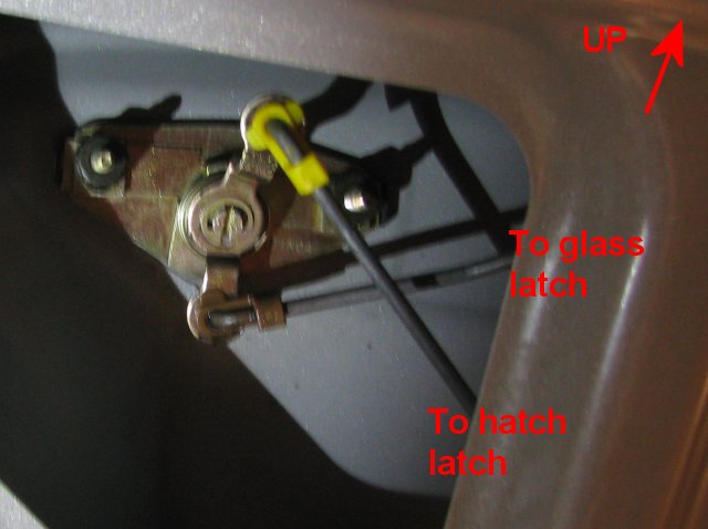

There are two rods on the lock, one goes to the overall hatch latch, the other goes to the glass latch

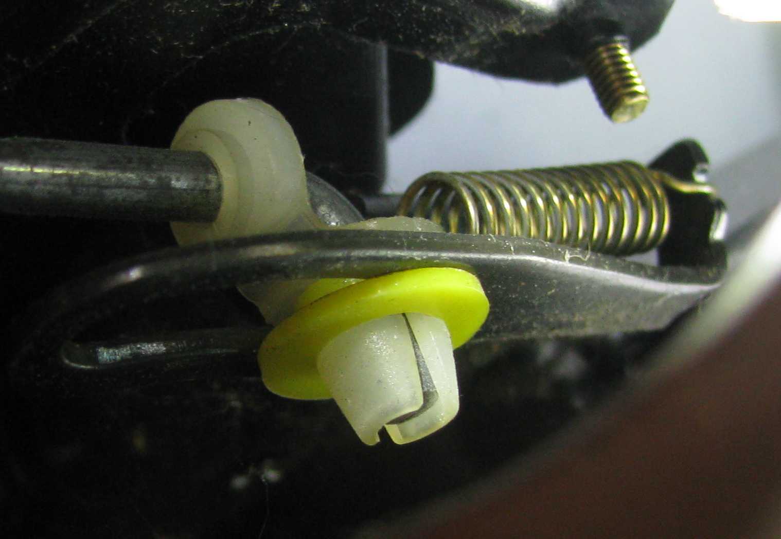

This pic shows the other end of the lock to hatch latch rod
Here's another pic, from the drivers side showing the lock rod attachment at the hatch latch
I'm not sure what to call or where to get the plastic rod retainer for the hatch latch side. Looks like it might be challenging to work in that space, with the extra complication of the spring. Don't know if it would be easier to unbolt the hatch latch to move it to a more accessible spot, attach the lock rod, and attach the rod to the lock after the latch was reinstalled. I mean, it would easier to work on the latch if it was loose, but then you'd have to deal with getting it back into proper alignment .

Thank you! That's exactly what I was looking for. I assumed that is where the end of the rod went due to the length of it....didn't think of the spring though, although it should have been obvious as it sits in a slot and not just a hole. Looks like I need the spring as well. I'll try the dealership, but think my only real option is from a parts car. Thank you again, it is greatly appreciated!!
