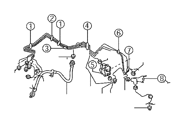

I'll try to find the toyota parts diagram for the Matrix again and link it or copy it, but yeah, line #5 is what connects driver's side brake hose to the rest of the hyrdaulic system.

I ordered the 03 Matrix part # 47315-02180 which is "Tube, Front Brake, No. 5". (About $9 plus shipping). I cannot find the diagram on the web that allowed me to figure out which tube I needed, but it was similar to the one below. Tube #5 is not labeled, it attaches to what is labeled with 8 in a circle. (source: parts.toyota.com)
