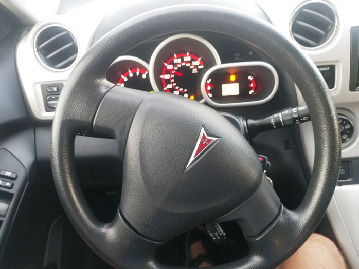

Hi all - based on the treads I was reading on the clunking of the steering wheel both when going slow over bumps and when wiggling it, I replaced the intermediate shaft. The clunking didn't stop; however, two other things happened: the steering wheel is now crooked and the VSC is permanently on. Have any of you ran into this issue before and what have you done?

2010 Vibe Base crooked steering wheel
2010 Vibe base crooked steering wheel.jpg (160.41 KiB) Viewed 1986 times

Update: local garage managed to straighten the steering wheel and clear the VSC light; however, clunking is still an issue. The front end is solid, with no loose components. Technician still suspects intermediate shaft...
