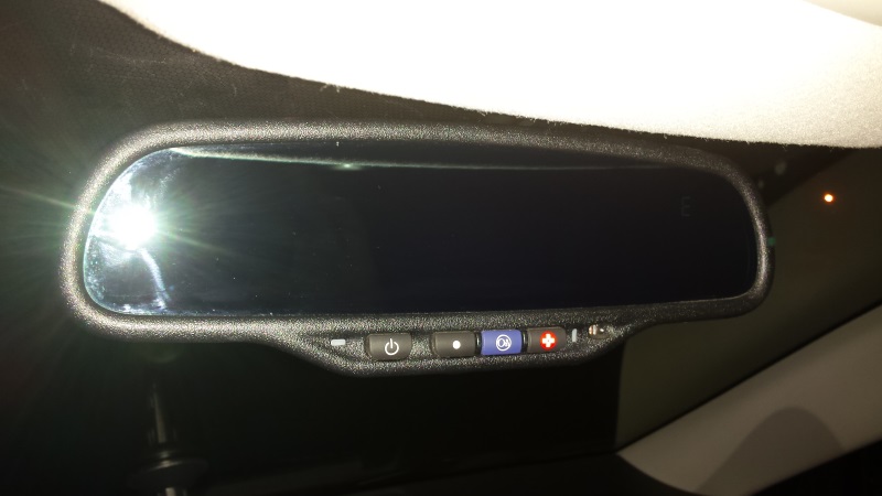

Stopped by the junkyard today and picked up an auto-dimming rearview mirror with compass, microphone and OnStar for $4 from a dead Cadillac. Hooray for Kenny-u-pull! Also snagged a mirror harness which provided a donor wire and pins as the 09 Vibe does not have 12V to the mirror. Ran 12V from the same fuse tap that does my dashcam and I'm in business!

Any further Detail on the mirror install? More Pictures?

2010GTJT wrote:Any further Detail on the mirror install? More Pictures?
I made a how-to thread on the mirror: viewtopic.php?t=45437

Doesn't onstar require an extra antenna? Or did you get it for everything else besides that?

BenWA wrote:Doesn't onstar require an extra antenna? Or did you get it for everything else besides that?
My car came with OnStar. The old mirror had Onstar but with manual dimming.

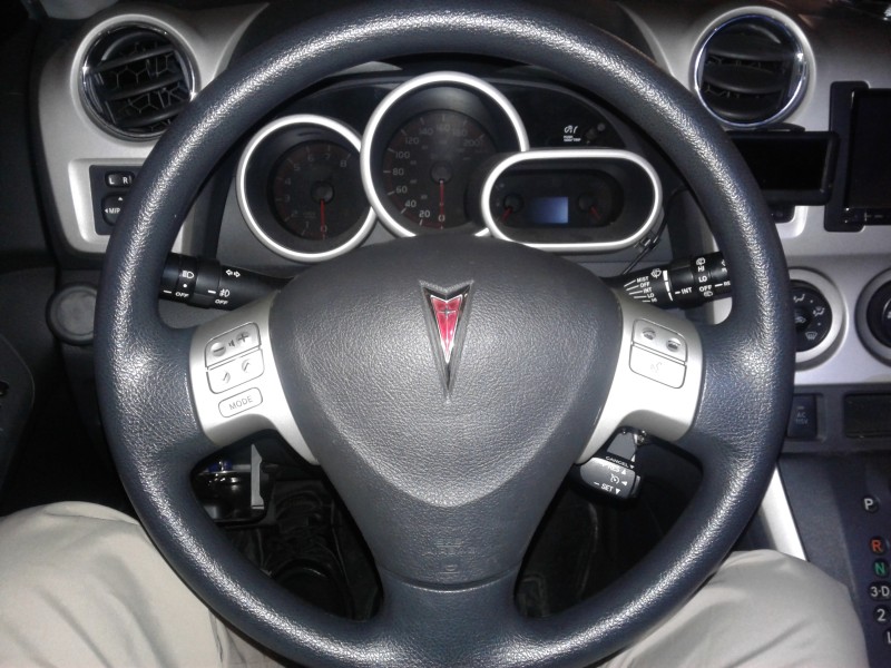

I made a how to on the steering wheel audio controls, because it deserves a thread all its own.
viewtopic.php?f=28&t=46067&p=518874
