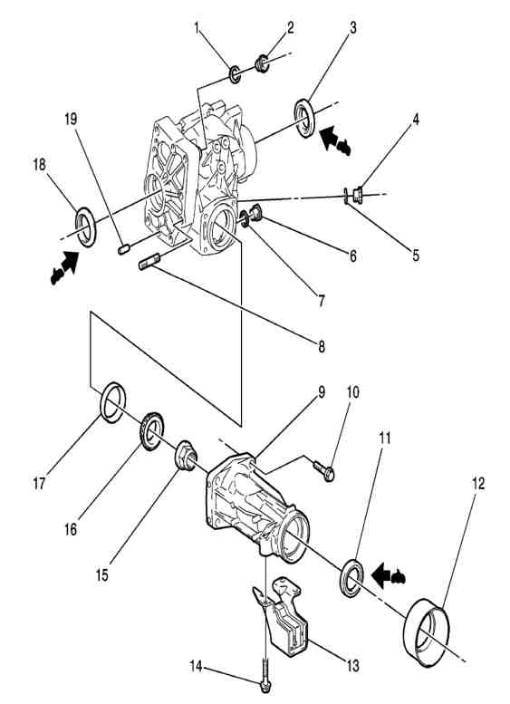

The pic in the post linked above shows the fill (top left) and drain (bottom center, red text) plugs for the 2009 transfer case. To check fluid level, on level ground or on lift, remove fill plug- fluid should be right up to the bottom of the hole (potentially seeping out). Should be a 10mm hex socket to remove plug and you'll likely need a breaker bar.

2009 Vibe Transfer Case
2009 transfer case.jpg (23.4 KiB) Viewed 21577 times
#6 is the drain plug
#4 is transfer case plug number 1
#2 is transfer case plug number 2
Plug torque is 36 lb ft

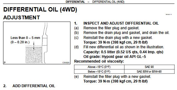

Anyone change out the rear diff on AWD ‘09 or any posts related to? Thanks
Posts: 10265
Re: 2009 pontiac vibe 2.4l awd front transfer fluid check??
PAL419 wrote: ↑Sun Jul 20, 2025 7:56 am Anyone change out the rear diff on AWD ‘09 or any posts related to? Thanks
All I have is this from the 03 Matrix manual
This is the procedure for pretty much any differential (and manual transmission) I've ever worked on, although I can't say where the drain and fill plugs are on yours. Basically add oil until it runs back out of the fill hole. Doesn't mention it, but park on a level surface. Also, you'd want to verify the same type of oil.
