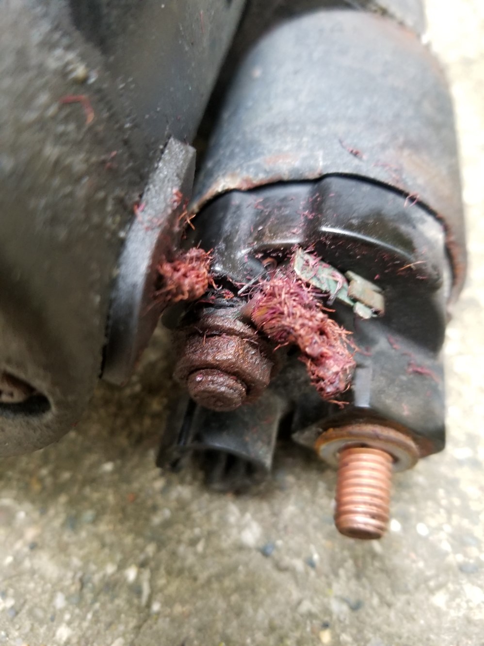

So the Vibe is up and running again. Here's what I did:
Tested the power at the solenoid's positive bolt - 12.2
Tested the signal wire at the solenoid - 12.2
Decided to take off the starter and stare at it. I removed the right-side bolt. Came out easily after the initial breaking loose.
Removed the left-side bolt. Took forever as it was fighting the entire time, even after penetrating oil.
Finally got them out and removed the starter....
The braided copper wire disintegrated in my hand. New starter installed and the car starts better than it has in years.
Thanks all : - )

It was the original starter. 2008 model. I have 155k or so miles on it. To be fair, I live in Michigan (road salt) and on a dirt road so the wire has been exposed to a lot of 'stuff' over it's life.
I did use penetrating oil on the bolt that removes from the driver's side and I wonder if that may have also contributed to the wire disintegrating in my fingers?
