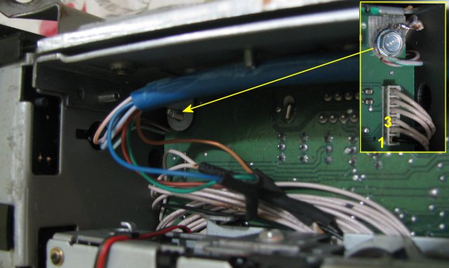

Did you keep any photos of where you connected the wires to the pc board and main amp?

I didn't connect wires directly to a circuit board. I cut the wires running from the CD player to the main board, and then tack soldered my wires to the cut ends. Not sure it particularly shows in this pic, the soldered wires have black heat shrink on them
The cat5 cable had eight wires in it, I needed 4 + ground, so I used four for the ground, although one would have been adequate. I cut the two wires on the CD player side of the main board (pin 1, the black wire, and pin 3, a white wire second from the black wire on the 6 wire bundle). The hard part was stripping the cut wire end down in the box using the the tools I had. Would have been easier to strip the wires if I removed the main board from the box, but it didn't seem worth it. I ran the grounds around and under the screw in the nearby corner, shown in the inset in the pic.
Used an ohm meter to verify that the cat5 coupler preserved wire color, blue on one end was connected to blue on the other, etc. Have to wire it so that the moving parts in the jack ( the parts that contact the inserted plug) connect to the wires leading to the board, the stationary contacts that get disconnected when a plug is plugged in connect to the CD player side. I didn't try to research and preserve left/right polarity.
