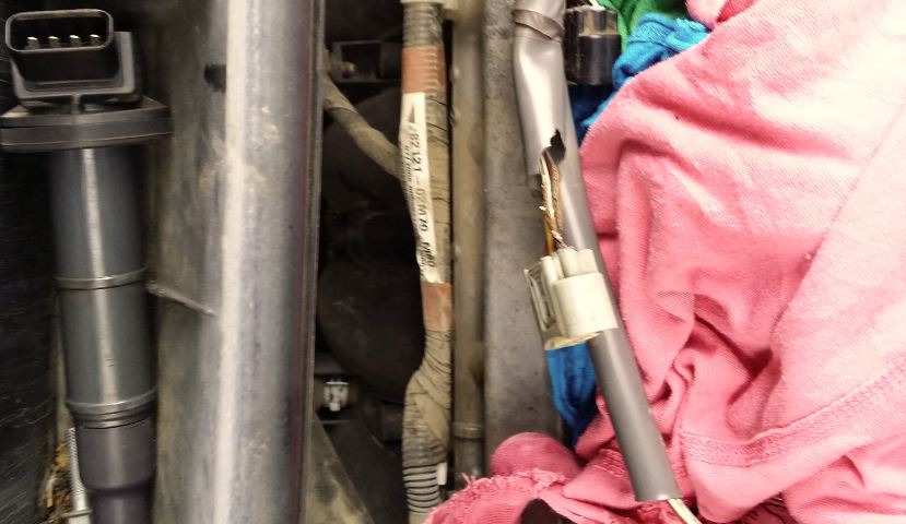

Check your wiring for your IGN system as well
https://share.qclt.com/%E4%B8%B0%E7%94% ... 020000.pdf
something was chew chew chewing my sparking coil wire
