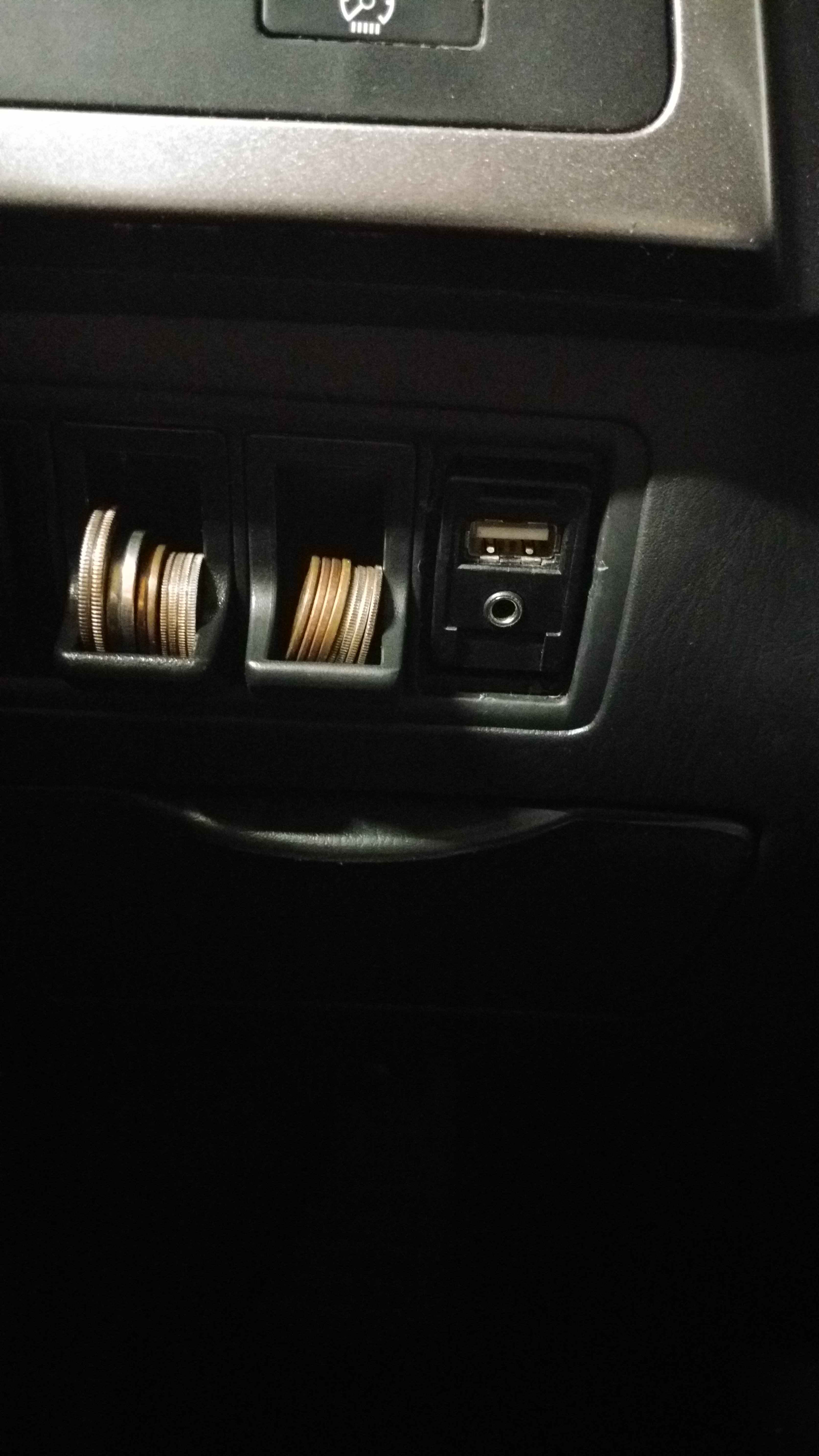

USB and aux in connection. I got the radio at a wrecking yard with all the wires, USB plug and mic.

Nice, one a kind install. With the USB port on the driver side, if you use your phone as a GPS makes easy wire run to dash.
