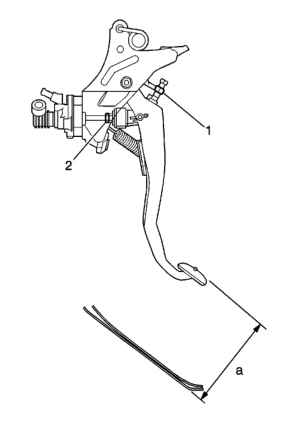

Since this is a hydraulic clutch, if an adjustment is needed, it is a good indication that something is bad with the system or worn out. That is why most people do not just adjust the clutch pedal. That being said, here is the procedure for the pedal adjustment.
Clutch Pedal Stop.jpg (22.36 KiB) Viewed 5483 times
1. Turn back the floor carpet.
2. Check that the pedal height is correct (a.
3. Loosen the lock nut and turn the stopper bolt (1) until the correct height is obtained.
4. Install the lock nut and tighten to 25 N·m (18 lb ft).

Pedal Height from Floor:
Engine Type Pedal Height: mm (in)
2.4L LAX - 166.4 to 176.4 (6.551 to 6.945)
1.8L LAY - 157.7 to 167.7 (6.209 to 6.602)
