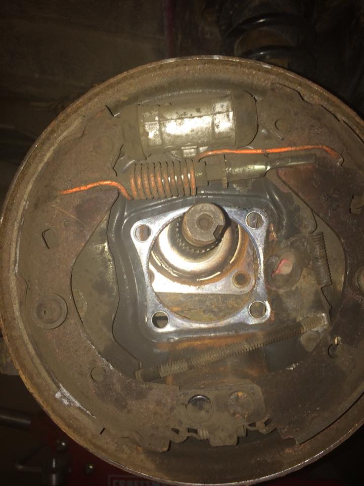

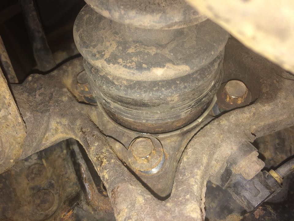

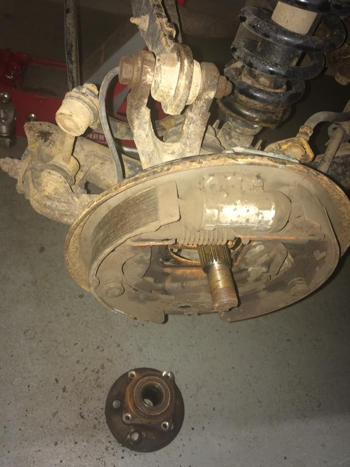

Finally got my hands on a new rear wheel bearing... The procedure looked excessively convoluted, so I skipped a few steps and left the control arm assembly in place, just pulled the axle nut, drum, four bolts from the backside and pulled the hub off. I had to get my die grinder in there to take some lip off that dust shield so I could access the bolts, and it took some chisel wedges between the control arm and brake backing plate to force the bearing out, it was rusted in place fairly firmly. I did unclip the brake line from the support bracket to allow some movement as the backing plate dropped. Had something of a heart attack when I went to slide the new hub on and the shaft jammed up on the spline halfway in... had to encourage it by tapping the hub with a hammer until I could catch a thread with the nut, and pull it through the rest of the way. ABS sensor and ring survived the ordeal. Brake shoes and drums are on order...

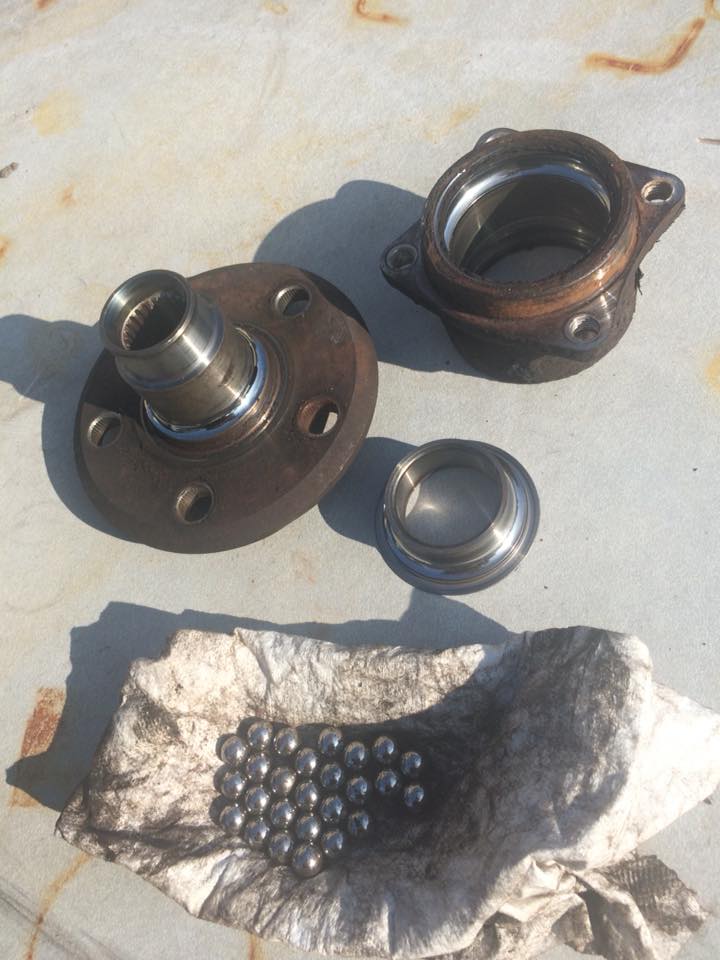

I pressed apart the old hub out of curiosity, it still rolled smooth but had gotten sloppy. The bearing cages had vaporized, but all the balls and races looked perfect. Zero evidence that there was ever any lubricant in there. McGuyver would have just repacked it and put it back in service. Now I'm wondering if I should have installed a zerk fitting in that new hub before I put it in...

hogdoctor wrote:Now I'm wondering if I should have installed a zerk fitting in that new hub before I put it in...
Just out of curiousity, how would you do something like that? And what type of grease would you use? Moly?
If nothing else, it looks like you have a couple dozen pachinko balls to use... :lol:

Find an accessible spot on the body, drill a tiny hole most of the way through the casting, then enlarge it up large enough for a 1/4" fine thread tap, cut threads with a bottom tap. Finally go back to the tiny bit you started with and drill through into the body cavity of the bearing, and install the zerk fitting. Moly is fine, any high temp wheel bearing grease would be better than nothing. "maintenance free" = disposable. Zerk fittings are cheap. Wheel bearings are not.
