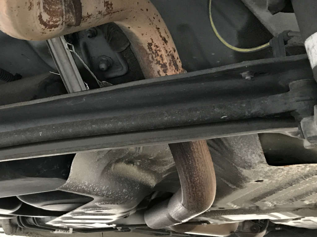

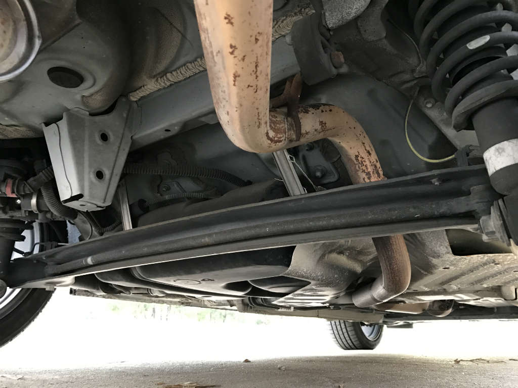

Post by RDG25 »
Also posted in another thread: Gas tank heat Shield. I have a 2003 2WD Base Vibe. If your heat shield over the gas tank has gotten rusted to a point where it can't be reattached or restrung (if applicable), some mechanics will tell you that you don't need it. But the heat shield protects the gas tank from the hot exhaust pipe & other objects below, and probably needed more as the car ages since the gas tank may be rusting. So I decided to replace it. The replacement parts are no longer available from GM. So I went to Toyota, trying to match the 2003 Base Matrix. But not any Toyota (local dealer was much more expensive, and no returns), I went online to Toyota South Atlanta (phone 404-363-1953 Gil, head of online parts orders). They charge a reasonable flat rate shipping charge. The parts that worked for me are: 1) 7764102030 (Fuel Tank) Heat Shield about $102. 2) Fuel tank strap band #1 77602-12250, about $47, and 3) Fuel tank strap band #2 77602-122210 About $53. They charge a reasonable flat rate shipping charge. https://onlineparts.toyotasouthatlanta.com/ Note that on the fuel tank strap #1 and #2, the rubber protector already comes with the fuel tank metal strap (to protect metal on metal between the fuel tank and heat shield). So there is no need to get separate rubber protectors. I'm happy that my mechanic was able to install them. I tried an aftermarket part for the fuel tank straps from Advance Auto Parts, and even though it says it fits my Pontiac Vibe, it does not. Stick with Toyota parts for this one. Note: Vibe AWD uses different parts.
