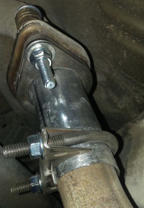

Well it finally happened. First the rust on the exhaust started on the pipe behind the muffler, causing it to be a little louder. Then the rust started to make a whole after the resonator, making the car even louder. Now it finally severed after the resonator completely.
It's a shame the only exhaust I can find is the Magnaflow one. That is way too expensive. I'm thinking about having a shop just fabricate one.

zbyers wrote:'Hopefully after my wedding in a few weeks I can take care of that.
How was the wedding, and Congratulations!

MrManager wrote:Well it finally happened. First the rust on the exhaust started on the pipe behind the muffler, causing it to be a little louder. Then the rust started to make a whole after the resonator, making the car even louder. Now it finally severed after the resonator completely.
RockAuto has all the pieces to make an exhaust if you are looking for a stock-like replacement. Or you canjust do the part of the exhaust that is busted. https://www.rockauto.com/en/catalog/pon ... &+emission

I see the muffler and tail pipe, and the part for the O2 sensor, but I don't see the intermediate pipe? after the resonator

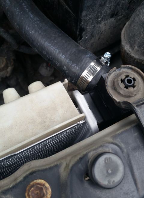

joatmon wrote:Found (and fixed) the source of coolant loss in my 03 trix
Glad autozone stocks our radiators
Found the source of the leak in mine, and it was in the exact same location. Wonder if that's a common leak point on ours. Picked up a denso radiator for $50 on Amazon and a new upper radiator hose and screw clamps.

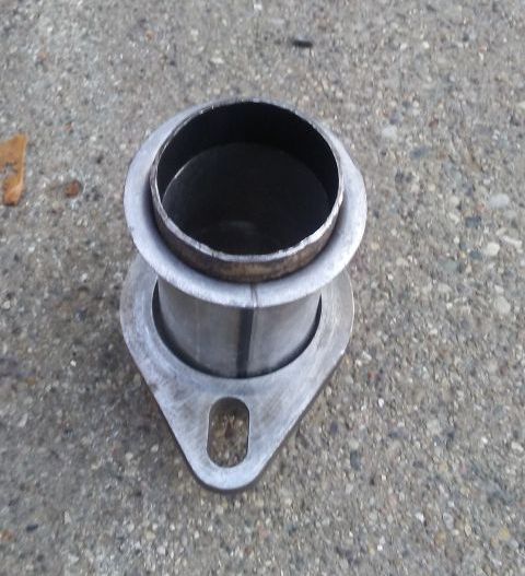

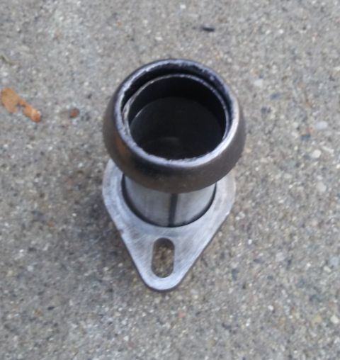

It broke at the beginning of the week. I have a temporary joiner half clamped on, but it rattles. I'm trying to see if I can get the flange apart so I can put a flange replacement on it.
I ended up fixing this not long after I posted this. Used heat and penetrant on the bolts as well as a breaker bar and was able to get the bolts out amazingly. Getting the old gasket out was fun, had to use a chisel, hammer, penetrant, and heat.
I used Walker 41727 flange to replace the broken flange. I had to cut the flange adapter's pipe in half because it was too long, there was a bend just after the flange. I also had to cut the exhaust pipe down so the new flange would fit over it. I used tin snips to cut notches in the end of the flange adapter so it would clamp properly around the existing pipe. I also took a small segment of the old pipe I had cut off and hammered it into the flange end of the adapter so the new donut gasket would have a place to sit on. I ended up using the same springs and new bolts and washers and a clamp to button it up. Hasn't given me any problems yet.
