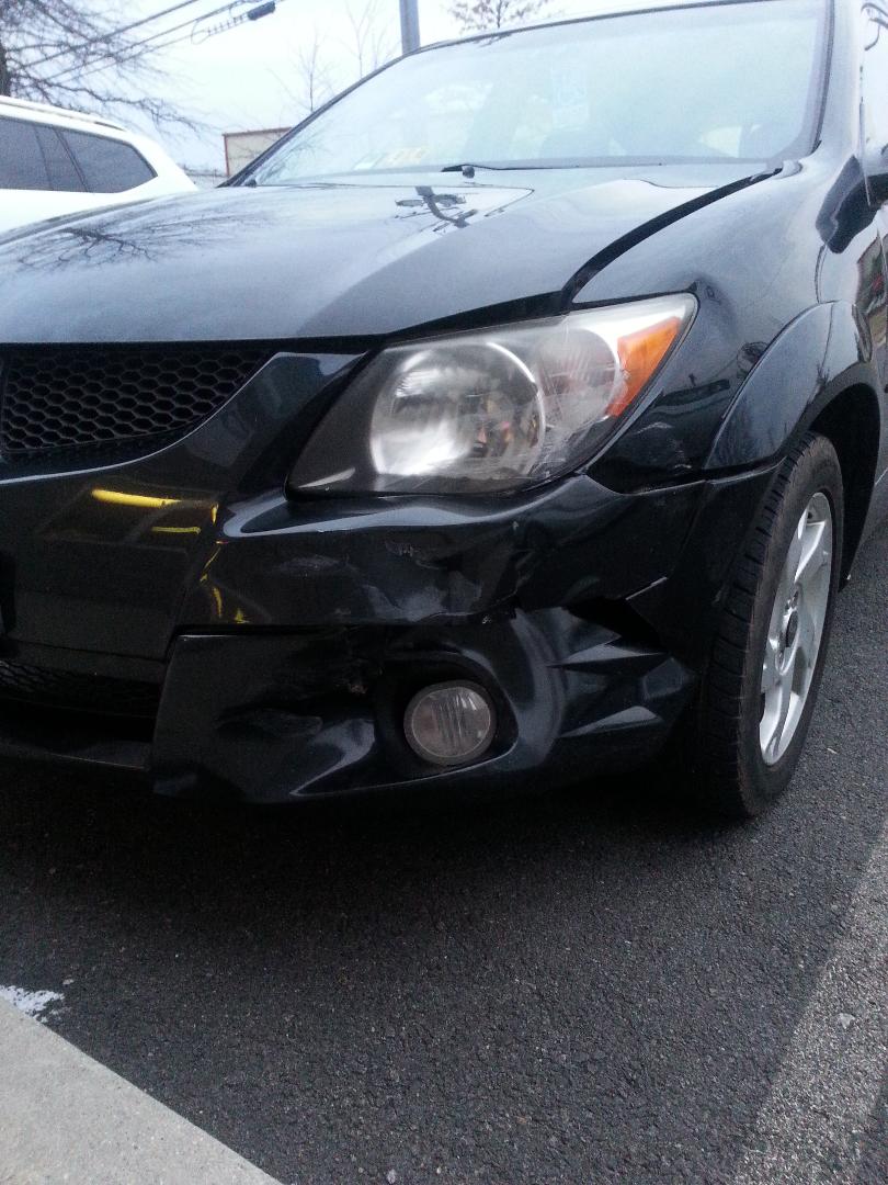

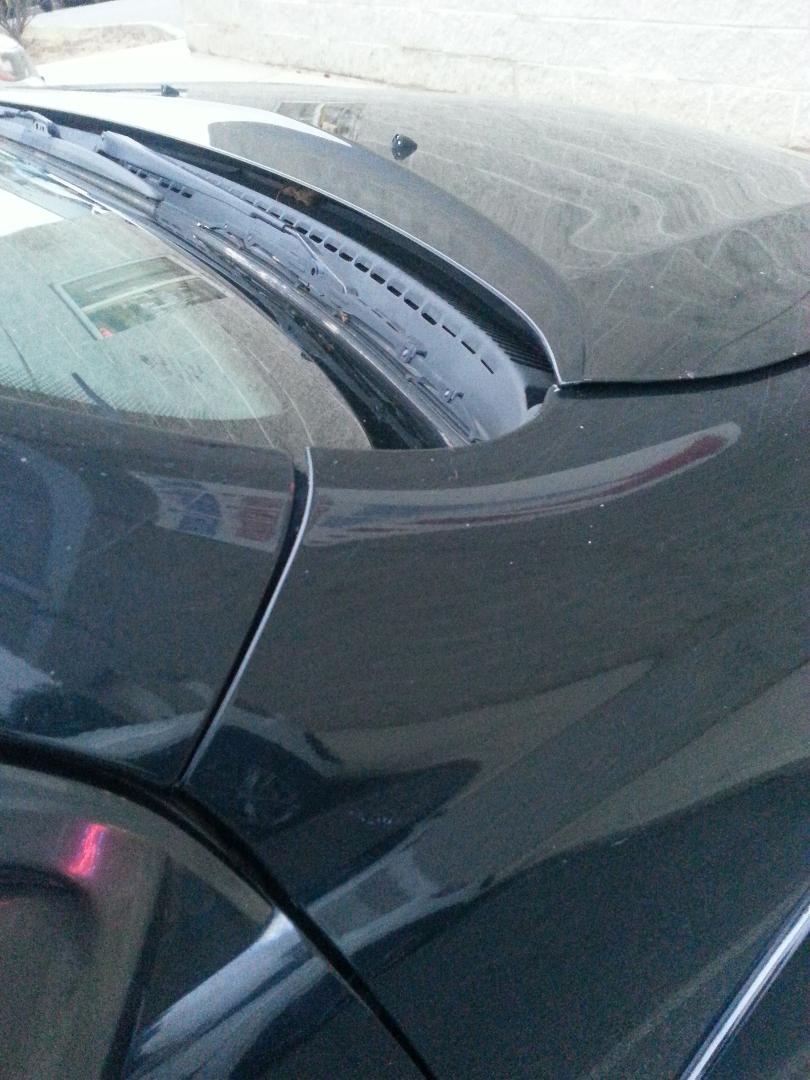

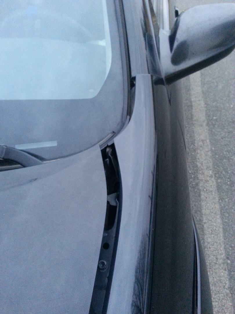

My beloved '03 base Vibe was hit on the drivers side corner of the bumper by an idiot in a new truck (his fault) and the insurance company has totaled it (with a very poor settlement, imho). So, now I need to decide - is it fixable or should I look for another one? My car has 253,000 miles on it, burns very little oil, strong trans, no rust, good paint except for a few dings and scratches. It's been a very reliable car and I really want to put it back on the road. Insurance gave me $1,100 for it. The collision pushed back both fenders, the drivers side moreso, but the drivers door opens and the passenger door does not. The radiator support is buckled a bit on the passenger side. Had alignment checked, it is fine. Drives fine, no damage to radiator or a/c parts. So, given that they only gave me $1,100 for the settlement, and the adjusters estimate was $4,000 (which was inflated by wanting a new passenger fender, which is undamaged, and paint repairs to the passenger door, which only has a chip), any advice? Thank you in advance!

So, to determine if the frame is in fact damaged, should I get someone to put it on a frame rack and measure? I was told that would cost $250 to just measure. The adjuster did say the frame rail extension on the drivers side that the bumper is bolted to showed that it had been compressed. However, that, I believe, is what the extension that the bumper is bolted onto is supposed to do in an impact - compress and spring back.

I'm not a body mechanic, but as this is a unibody car I don't think anything can be straightened, to factory standards at least. Bent members need to be cut off and replacements precisely welded back on. Thus the high cost of repair. Crumple zones are good until you need to repair a bad fender-bender like this one.
If it were my project car and I really liked it and only had $1100 to work on it, I might try disassembling the front end sheet metal and radiator and see what I could do with hammers, fabricated levers, and come-alongs on the bare structural members. That would be an attempt only to get the doors and hood working, and the headlights aimed, not perfection. If that all works, you could look for a new bumper and cover. I don't know if you'll get a body shop to perform that low a level of work.

Since the collision was such that the passenger door no longer opens, that is probably enough to total it. The insurance amount does seem low. If you have any receipts for major repairs done in the last 6-12 months, you may be able to get it adjusted higher.

With the alignment unaffected it looks fixable to me. I'd have a body shop check what 's keeping the passenger door from opening. Probably the fender. I would bend the radiator support back as good as possible and have the front pulled back to make the hood line up again.
