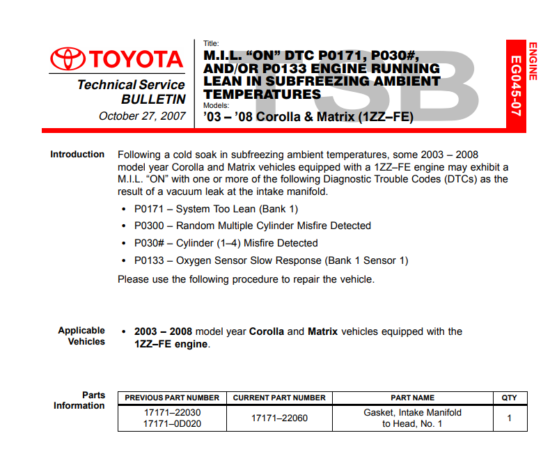

I'd start by replace the intake gasket. Only get the updated orange gasket from Toyota. It shouldn't cost you more than $20 and is relatively easy to do. I've done it on two different 1ZZ cars now.
I'll link you to a post on Toyota Nationhttp://www.toyotanation.com/forum/132-c ... -pics.html, which was also linked from this post here on GenVibe: viewtopic.php?t=43828.
It explains the replacement procedure and gives you the part number. I've found it easier to go to the parts counter with a part number, instead of going to counter and saying I need a part for a "Matrix". There's fewer questions. There's also a link in the first post which will take you to a Toyota TSB PDF that lists a P0300 as a possible code from a bad intake gasket in cold temps. I've attached a screen shot from it.

Have you tried to replace the intake gasket, yet? Its cheap and pretty easy to do and I have already proved to you by posting a Toyota TSB that it can be responsible for code you received in the circumstances you described. I'd start there. I even posted a link to instructions to walk you through it.
If you're concerned about an exhaust leak, then you could take your car to an exhaust shop to have them check it out for you. If there is an exhaust leak before the downstream O2 sensor, then yes, it will most likely throw a code. However, I don't think it would be a P0300. I would expect to see a P0420 (cat efficiency code). If you're hearing exhaust louder in the front, are you sure you're not hearing the intake or some sort of vacuum leak? Maybe take a video and share it with us to help pinpoint the sound.
