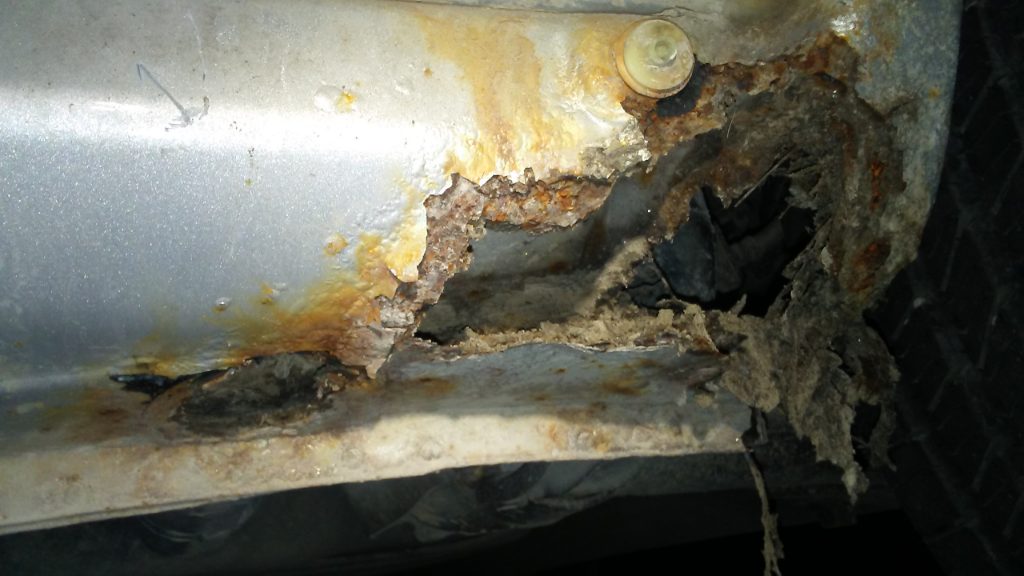

So, a week ago the rocker panel cover on the passenger side fell off. Oops. Before slapping it back on, I decided to go ahead and examine the panel for any rust spots and clean them up and re-paint them. That is, until I found a squishy spot in the back near the rear wheel. Some prying and poking later and I was able to remove most of the rust and leave a hole in the rocker panel. Yay.
I thought I could bondo it closed, but part of the problem was there was a ton of fine sandy dirt in that spot, moist dirt that probably caused the problem. So I considered that I could just clean up the edges, paint and seal the edges to prevent more rust, and put the covers back on, and that would give a place for dirt and moisture to escape.
And then I pulled off the driver side rocker cover.
Even worse, and it had rusted through to the rear wheel well space. And a ton more dirt around the rust hole. I blame that little shelf in front of the rear wheel where dirt seems to easily accumulate. So, what do?
I could still just clean up the edges and paint them and keep a hole of sorts so dirt doesn't get trapped in the rocker tube space. Or, I could bondo the holes shut. Don't have a welder to weld it closed.

The long term fix is to cut the old rusted panels out and weld in new sheet metal. Anything short of this just a patch job. To get a few more years out of what you have and the seal out dirt, noise, etc.. I would try this:
- Cut out or grind off as much rusted metal as possible. Try to get to some good metal that is rust free and shinny when you grind on it.
- Clean the inside of the rocker panel to remove dirt and scrape off any loose rust. A wire bush in a drill and/or 4" angle grinder cuts the work load on rust removal.
- Cover all the exposed areas (areas that do not have paint on them) with Navel Jelly or similar product that chemically converts rusted steel. Put on at least two to three coats.
- With the inside of the rocker panel clean and coated, spray some expanding foam into the rocker panel hole. If you have used expanding foam before you should know what to expect. The stuff is very sticky and will push out. You may want to use a plastic trash can bag to help hold the foam in as it expanse out the hole.
- Once the foam is setup, you can trim off the extra foam to match the outside of the rocker panel with a knife or hack saw blade.
- You can try to paint the area after this but most paint solvents will eat the foam away. You may want to try some plastic paint on some cut off piece of foam first to see how it reacts.
- Put your plastic cover panel back on to cover it all back up.
At least the hole will be sealed and the navel jelly will slow the rusting down for a while. If you do not get the area clean, the foam will not have a good seal with the metal. This can cause rust to forum even faster because moisture can get trapped between the metal and the foam. A lot of pickup boxes used foam from the factory around the wheel wells. This is a hack way of sealing it but it is cheap, not a lot of work, and you will not see it as long as the plastic panel is covering it. You'll get a few mores years of dust free and reduced noise when driving.

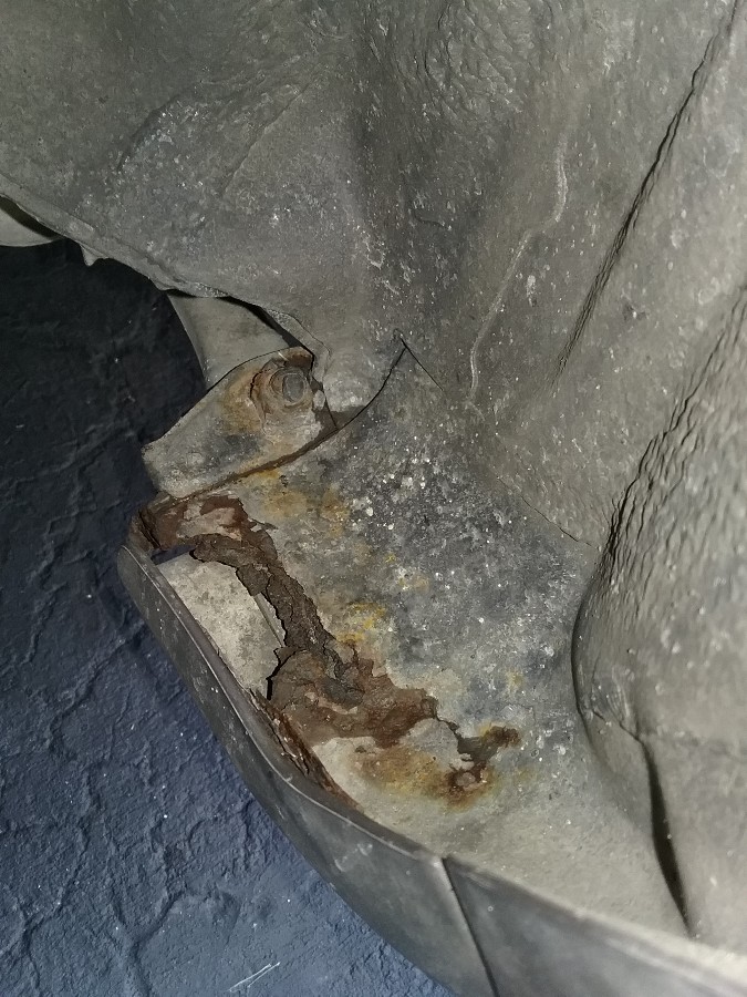

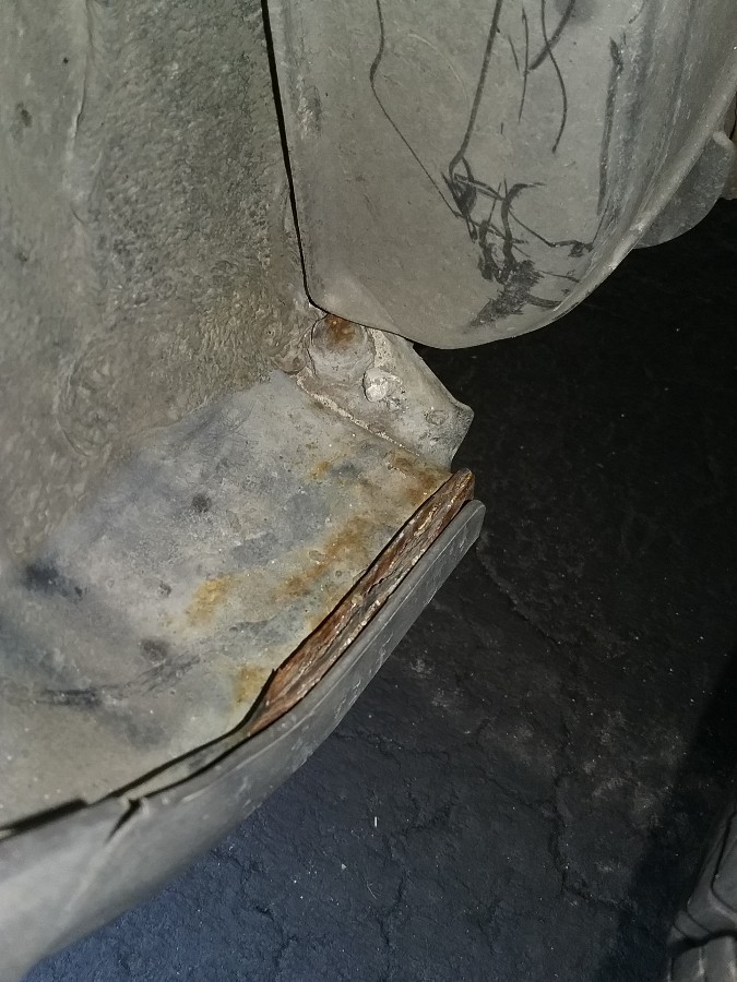

Posts: 8444
Re: Holes in rocker panels
Happy 16th birthday - you have cancer!
Driver's side isn't too bad.
20181020_105158 - Edited.jpg (154.14 KiB) Viewed 7473 times
Passenger side - not so great...
20181020_104931 - Edited.jpg (191.48 KiB) Viewed 7473 times
There was a lot of broken metal on the shelf on the passenger's side sitting there loose. I went ahead and vacuumed the chunks out today. Clearly a permanent fix is a lost cause, but I suppose I will try some DIY things to see if I can at least slow the cancer's progress. Poor old girl. :cry:
I am fortunate to have the luxury of leaving her parked when the roads are salty. Haven't really driven her much over the last few winters.
