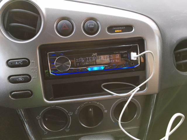

Driving back from the beach Thursday, the radio LED display started to go out. I heard of this being an issue so I ordered a new JVC stereo & install kit from Crutchfield . With all that driving, I depend on a good radio and really wanted an aux port, so this is well worth it. Install TBD.

New radio received and installed today. Ordered from Crutchfield - $80 "out the door" with everything needed for installation save for the wire crimps ($3.49 for a pack of 10 at the hardware store). Installation took about an hour and was fairly straighforward. I have no moonroof, so I presume no moon & tunes package. I did not need the extra red wire connection that has been the subject of some confusion in prior installation posts. Antenna simply used a converter to fit in the new head unit.
Pretty psyched to ditch the FM transmitter and I like the little extra storage under the stereo (perfect for phone). Initial tests sounded pretty good, though the lack of quality speakers was pretty evident at higher volumes. Those aren't a priority at this point though - just happy to have a hardwire connection to podcasts and pandora.
