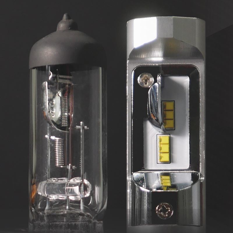

Finally cut the wire of DRL and Installed LED headlights.
These light bulbs have the LEDs in the same places of the filaments of the 9003 halogen bulbs. So they give a comparable light pattern with the factory reflector. They are not too bright but better than the factory 55W halogen. And they are just 35 Watts each. Also, the headlight lens covers are much cooler after a long trip.

petervivian wrote:Finally cut the wire of DRL and Installed LED headlights.
Post pics !!!! Where did you get the bulbs ? Post pics please !!! 8-) 8-) 8-)

I have changed back to the stock halogen bulbs. The LEDs surely look white, but the illumination on the ground is not better than the halogen in the reflector designed for the stock bulbs. Now I think the only real upgrade to our old headlight should be HID projector.
Interestingly I found some smaller HID projectors that fit through the opening of the stock bulb. They claim of very good cutoffs (I believe it), and better illumination than the stock halogen. Which I am not sure since the diameter of the projector lens is much small than these retrofit ones people normally put in the headlight housing. I need to get a set and do some tests.
