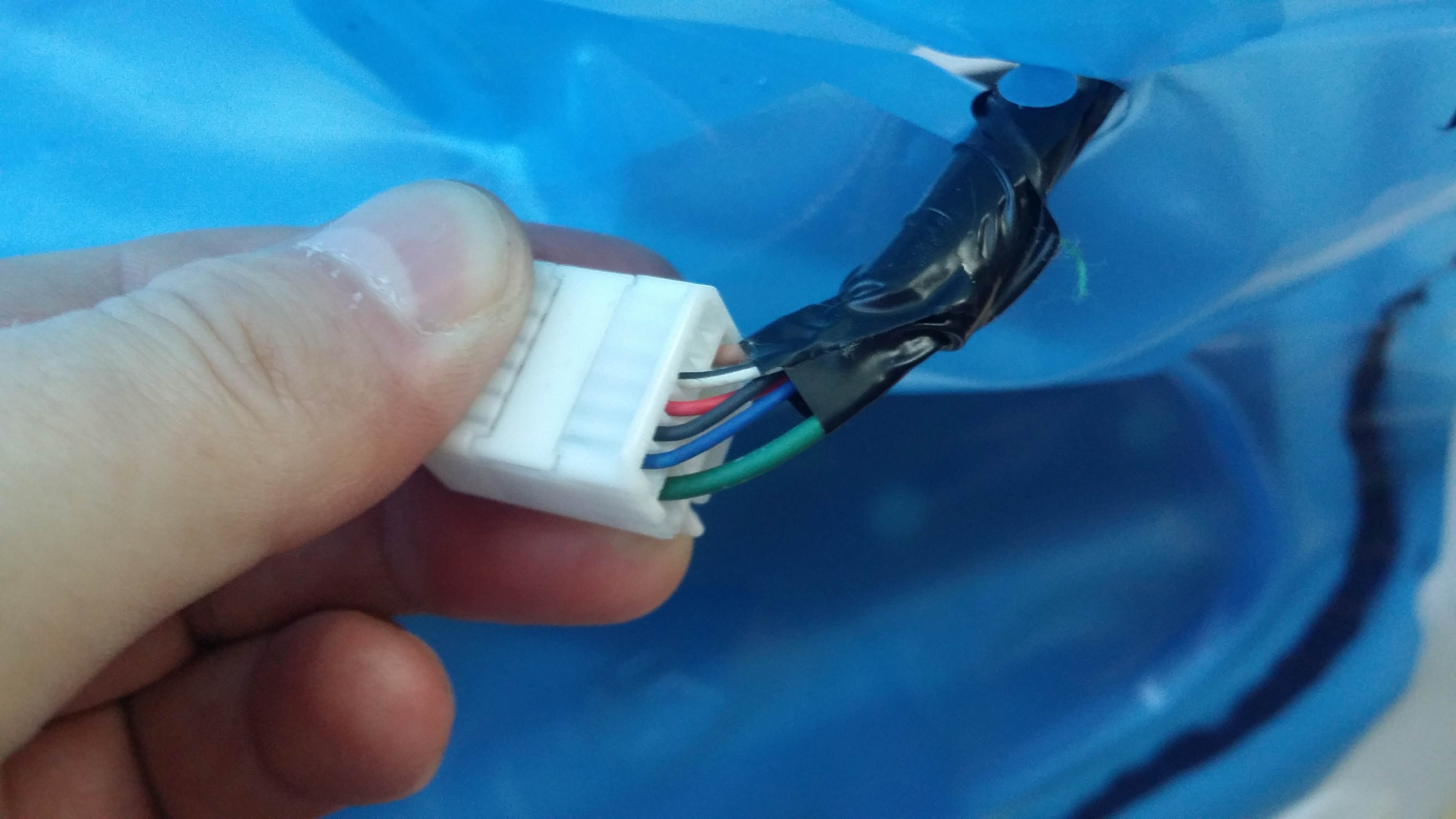

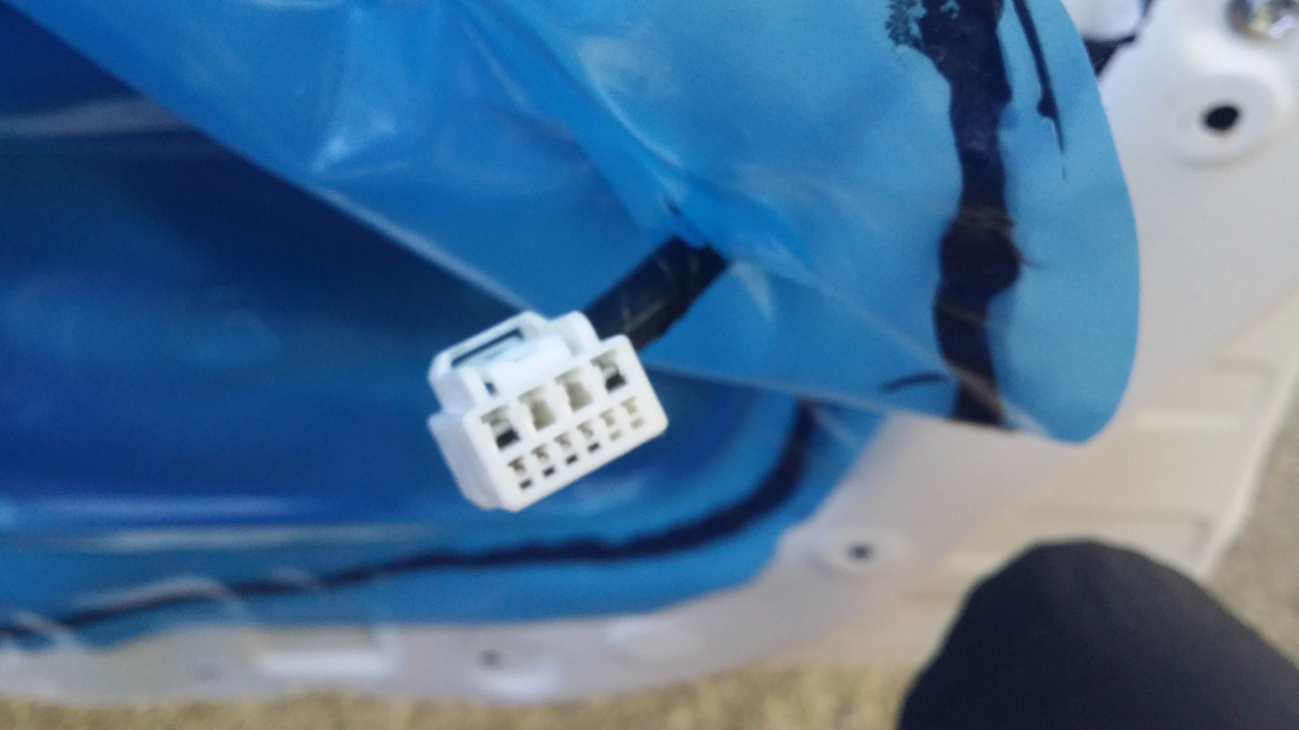

Here is the plug I took off the actuator:
Actuator plug
Actuator plug
I tested across the green and tan wires shown here (to a bolt on the door):
Actuator wires
Actuator wires

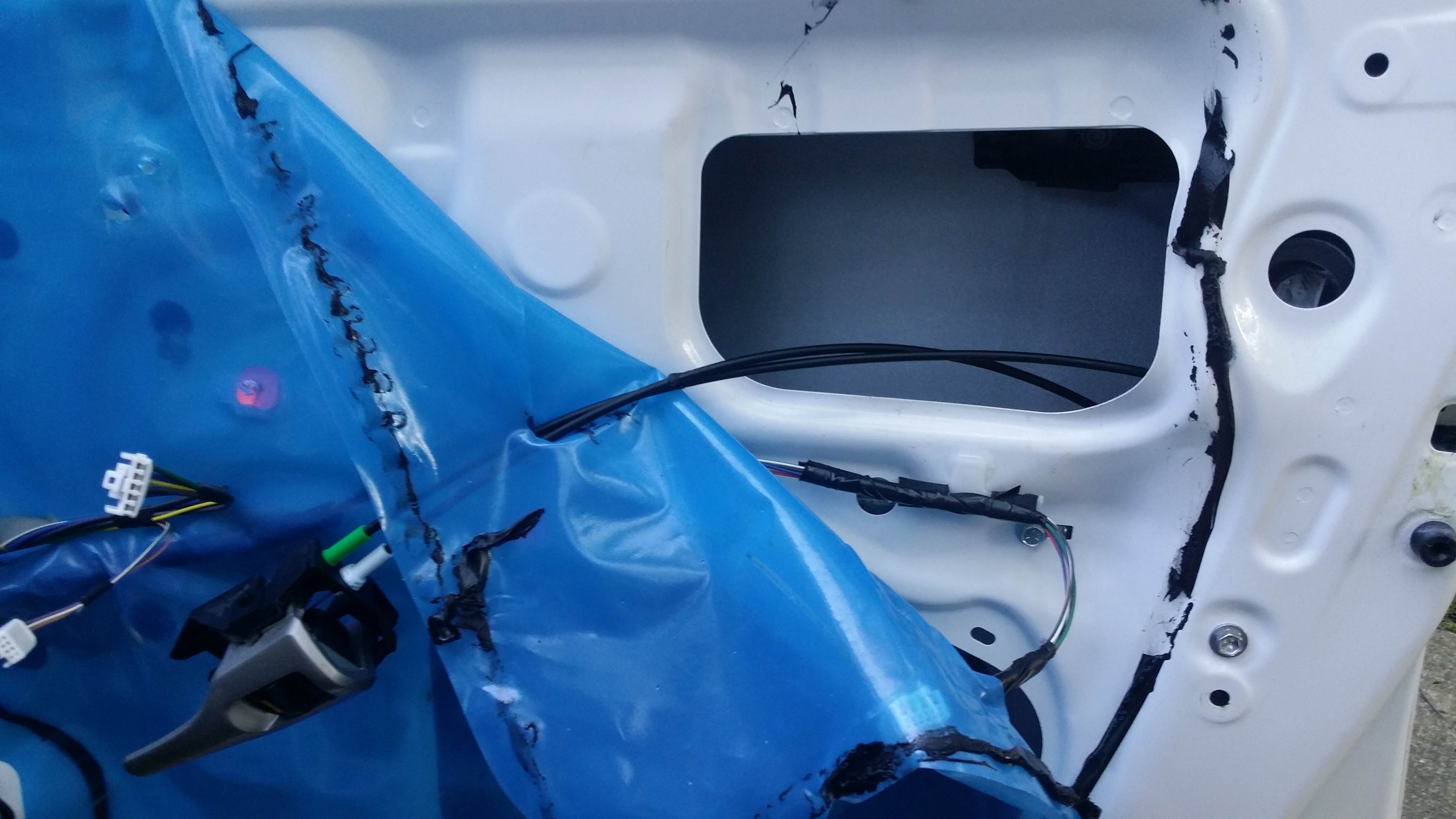

This is what the rod looks like that attached to the top and prevents me from taking it out:
Rod attachment
Rod attachment
Here is what it looks like with the panel off:
Panel off
Panel off

Does the passenger lock move at all when you hit the switch? I had a similar problem on a Toyota Highlander and had to replace the small motor inside the door lock actuator. They don't cost much compared to replacing the actuator unit and you pretty much did a lot of the work to get to the actuator already...
Do a google search for 'toyota door lock actuator motor' and you'll find lots of info on the motor, where to buy, and how to replace the $6 motor inside the actuator.
