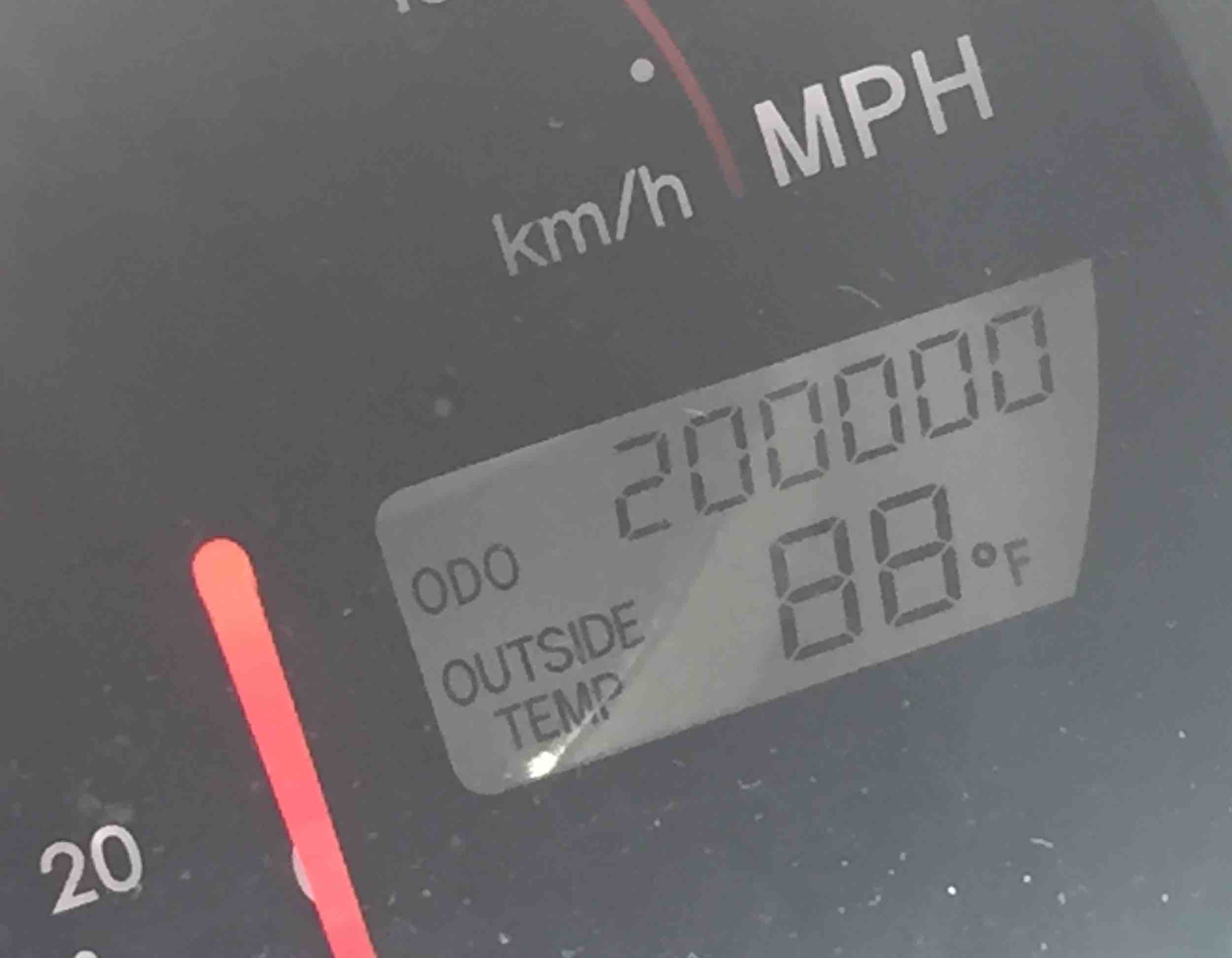

Thanks all! Today was the day, pic attached. What an outstanding car.
