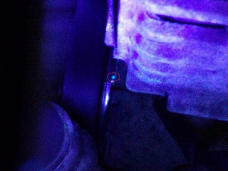

How long does it take for the dye to show up? Right now I'm not seeing much, except a tiny dot between the compressor and the clutch as in the photo below, circled red. Still waiting for it to get dark but this has me concerned it's the seal...

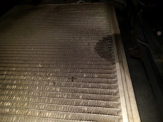

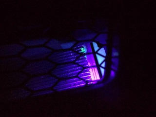

Ok, I checked as thoroughly as I could and found a spot on the condenser that's glowing. A regular photo shows what seems to be a shadow but now I suspect is oil or something leaking through. Unfortunately photos are not from the same angle.
So I'm guessing I'll have to replace the condenser. And from what I read, also the receiver dryer. Should I try OEM or are aftermarket parts fine? Does the system have to be flushed and does oil need to be added? How much? I'll look for some DIYs but any info or help is appreciated!

Nice research. All refrigerants carry oil throughout the system from the compressor (open ... belt drive, semi-hermetic, and hermetic) so when there is a leak of any kind, oil residue is usually present. Looks like you need the condenser for sure. Not sure if you'll need to replace receiver also unless it is an integral part of the assemble.
