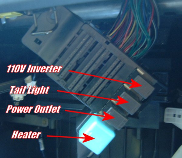

There aren't a lot of things to cause both no blower and no light on the AC switch, and not sure if any are particularly likely to be affected by cleaning. Power for both comes from the 40A Heater fuse in the under dash fuse block, then through the Heater relay which is on the top side of a junction block up over the glove box. Heater relay is engaged when the fan speed setting is anything except off. The Heater relay also provides power to the 10A AC fuse, which is what would give you the light on the AC switch.
The heater relay is in the same junction block as the Tail relay, and a very few people here have had the Tail relay become unseated, so it might be worth taking out the glove box, reaching up and making sure that the Heater relay is seated. download/file.php?id=33
