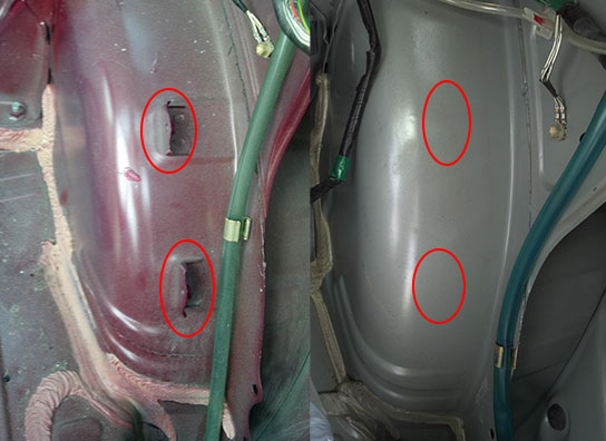

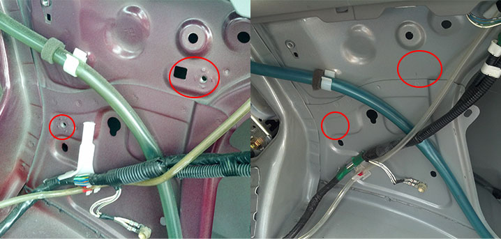

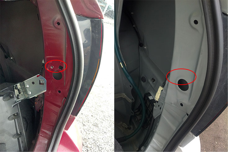

Here's something I discovered while picking up the speaker. Take a look at the differences between the 05 with the sub (red), and my own sub-less car (gray), which I thought originally had a sub that may have been removed because I have a sunroof, tweeters, and amp under the seat, as well as the plug for the sub. Red circles show differences that I noticed.
So obviously there's mounting hardware my car does not have.
The two at the top along the quarter panel would be the easiest. Drill holes, and I can easily reach behind to thread nuts on bolts. Door bracket is harder, because there's no way to get into the door edge cavity... I'd have to just use a steel screw or something.
The brackets on the wheel well stump me. I could easily just get brackets from a hardware store that might work, but I would rather not drill holes through the wheel well that could let in corrosion and water later on. I could possibly weld on brackets if i could find someone willing to weld them on, I guess.
Thoughts?

Just bend up a couple of pieces of sheet metal, and use panel bonding adhesive. Drop by any body shop, they'll stick them on for you.

jayoldschool wrote:Just bend up a couple of pieces of sheet metal, and use panel bonding adhesive. Drop by any body shop, they'll stick them on for you.
I hope so. Looking up that panel adhesive, it's $40 for a small bottle. I had also considered JB weld but wasn't sure how well it would stay on.
An idea I had was to run very long threaded bolts/rods from the inside panel the speaker is attached to and to where the brackets would normally be. Or, screw pieces of wood from that panel to where the brackets would be, and then attach the bottom of the speaker to the wood beams.
Speaking of which, maybe I should go back to that car and try to cut those brackets off. You guys think I'd be able to do that? They don't allow power tools that release sparks (like angle grinders and cutting wheels) into the yard, but drills are okay.

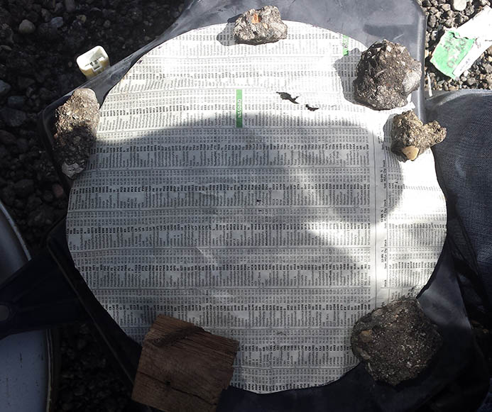

Here's a picture of the second gen box with a circle that's 10.5" in diameter, which is about as big as I'd say most 10" subs are. Never mind the rocks, it was quite windy. Seems to fit. Of course there would be a sub mounting ring underneath that. Might be something worth giving a try.
