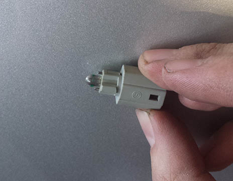

And I have the cigarette lighter option with the green ring around the socket. I pulled the lightbulb from a junker and this is what it looks like:
I have a feeling this is a special bulb that is dealer only. However, if someone could get a LED of it, the lens around the socket is clear, so you could change the color of the ring if you wanted.
The rest of the bulbs for the buttons looked like nox t4 or t3.
