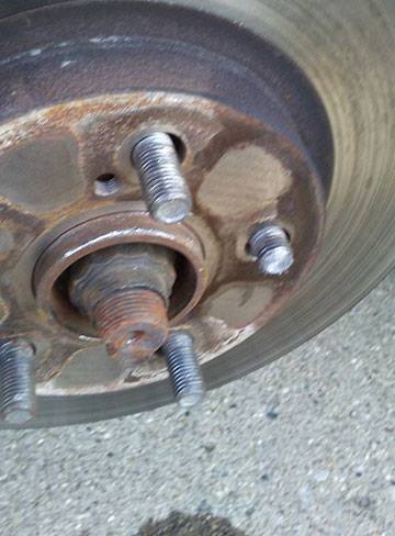

Back in Feb I bought a pair of tires from Walmart, then bought another pair again. $350 for cheap but decent tires. It wasn't the tires that were the problem though. When trying to remove the front wheels in the past couple weeks I noticed the lugnuts felt way too tight, and some of them were bigger than the 21mm socket. Seems some were having the problem listed in this thread: viewtopic.php?f=20&t=45885&p=518429#p518429
What I think happened is the idiots at walmart overtightened them or hit them with an impact wrench, and that might have very well warped the rotors as well. Not only do I have to replace some lug nuts, which might have been their fault or just because I live in Michigan, I now have to replace a stud, because when I was trying to spin it off it was stiff, creaking, and then it snapped. Nice.

bigdoug, did you notice in your picture that the ends of the wheel studs are not rusty like the rest of the bare metal is in your picture. That because the wheel studs are zinc plated. The zinc platting keeps the studs from rusting and is a lubricant for the threads. Zinc is a very soft metal and will wear away from the threads under pressure. This can be seen if you look at the threads of your studs. You are down to bare steel on the threads. Steel on steel with no lubrication will wear faster and can cause the threads to gall. More info about this here: https://www.boltdepot.com/fastener-info ... lling.aspx
Back before they started zinc platting the studs, the manufactures recommended putting light oil on the stud threads before torquing the wheel nuts. Guess what a quality anti-seize is made of.....zinc! By using this, you are replacing the dry zinc lubricant that has wore away from repeated wheel nut removal and installs with the zinc that is in the anti-seize. Does this change the clamping load when torqued....yes. It gets the clamping load of the fastener back to were it should be with a lubricant of zinc that was there from the factory. If you read the link above in this post, see "Slow Down Installation Speed", which is the opposite of using an air gun to spin the nuts on like the wheel shops do. The nuts should go on by hand and tightened by hand. Take the torque up in steps in a cross pattern on the wheel studs like I said in my first post above, and when it comes to anti-seize, a little goes a long ways. Use it sparingly.
