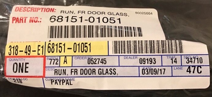

Best price available is 61 each for the front door run channel of my 05. I also need new cowl seal but this is expensive too.

Re: Window weather stripping.
Post by petervivian »
So I bought a toyota matrix (07, 08) run channel. Fits perfectly.

If you have the 03-08 model, I just pulled off a pair of the weather strips off a 2004 Toyota Corolla in a junkyard and they fit perfectly. I even laid them side by side with my old Vibe strips, and they were an exact match. I'd say get some of the same.

Hi, bigdoug, that's exactly what I found out after changing the driver side window weatherstripping on my 05.
Those interested in changing theirs can also search this part for Toyota Altis. They cost much less than the one for corolla or the vibe.
