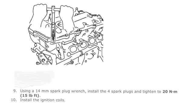

Below is the info for a 2009-2010 Vibe spark plug install from GM for the 1.8L engine. The steps are remove cover, remove coil packs, remove spark plugs. Some of the strange info that is in this picture is that they call for a 14mm spark plug socket. I have the 2.4L engine in my Vibe and that section does not say 14mm spark plug socket. My 2.4L used what I would say is a normal spark plug socket which is 5/8" extra deep spark plug socket, which is pretty common for cars now. A 14mm spark plug socket very close to 9/16" and they do make extra deep spark plug sockets in both 9/16" and 5/8". I would guess that if the plugs are 9/16" and a person tried to use a 5/8" socket that either the socket would not go all the way down into the spark plug chamber, and if it did go all the way down that the socket would not grip the plug. GM has print wrong information about other things for the Vibe so this would not be the first and I can not confirm this because I have the 2.4L which does use a 5/8" socket for the spark plugs.
Also, here is a link to extra deep spark plug sockets on Amazon:
https://www.amazon.com/s/156-0135626-07 ... ex=blended
I found over at a Toyota forum that the '09 and up use a smaller spark plug that is 9/16' or 14mm, which is different from the size used in '08 and down. The manual for the Vibe is correct on this.
