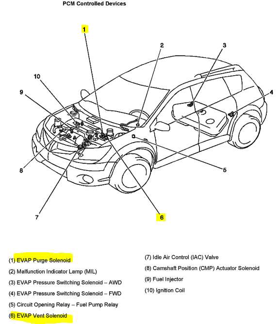

I need to find a layout of the evap system to see what hoses go where and what components are involved. I am sure it is likely an old hose or something but I am not too sure where to start looking.
If you know of any threads covering the EVAP system and can link me that would be great. I will also take a peak around myself as well.

Here is a partial evap diagram I found on the web. It should not be too hard to identify something and following the hoses and wires.
vibe evap.png (80.9 KiB) Viewed 4768 times
