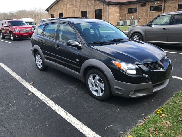

Welcome to GenVibe! Very sharp looking two-tone Abyss! Thanks for posting a picture right away ;)!

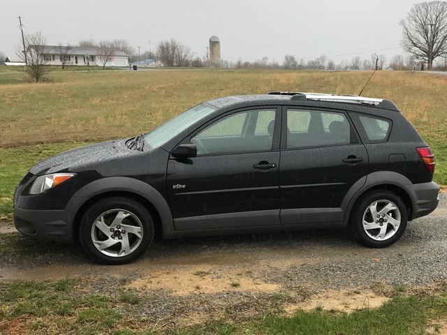

heres some more pics...not bad for a 14 yr old. Im still getting a little rough idle, that I can feel some vibration inside the car. Just put in a new PCV valve also. Any suggestions???
Re: New Member 2003 Vibe
4 cylinder engines are inherently unbalanced and vibrate in particular at idle. Many large 4cylinder engines are therefore equipped with one or two balance shafts.
Of course if it vibrates more than usual then you may have some misfiring or the engine/transmission mounts are failing. There is rubber in these mounts therefore they may be failing after that many years.
