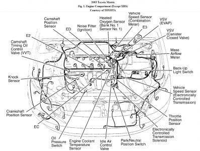

I like CRC spray cans for their intended purposes. I also use CRC MAF sensor cleaner for various jobs because it evaporates completely and does not attack plastics. On corrosion you could try a tooth brush and get more serious with a small wire brush if needed. Chop sticks and tooth picks are useful too.
Here is a under hood diagram of a Toyota Matrix (same as Vibe) The ECU is actually under the dash , driver side. Leave that alone for now, just check and clean things under the hood.

That is a fantastic diagram! I'm familiar with the things attached to the throttle body and the mass airflow meter. I think I already have a can of that stuff in the garage, I'll have to check.
