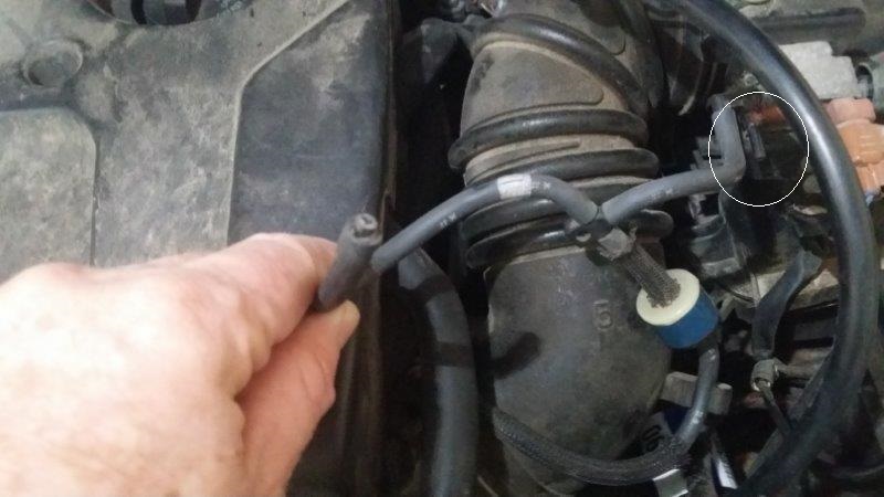

Was driving the other day and at some point when I let off the accelerator the engine continued to run at about 5K+. Got it home, turned it off and left it. Been sitting a few days and I just turned the key and it reved up just like as if I floored the gas pedal. Opened the hood just now to look to see what might be the problem and I notice these lines flopping around and wonder if that has something to do with it. The first pic shows a connection but nothing is attached. That may have been that way a while for all I know. The second show a hose with a broken connection but I can't find where that may have been attached to. Now I thought it may have been the spring at the connection of the throttle cable but that has tension and looks fine. Any ideas appreciated.
Re: VibeGT - Engine high reving on its own
I snapped a pic of mine, and it looks like the end in your left hand goes to something under the intake ducting. There is another tube that goes from under the intake duct back to the open port on the solenoid.
I can remove the intake ducting and take a pic of the vacuum routing if you want.

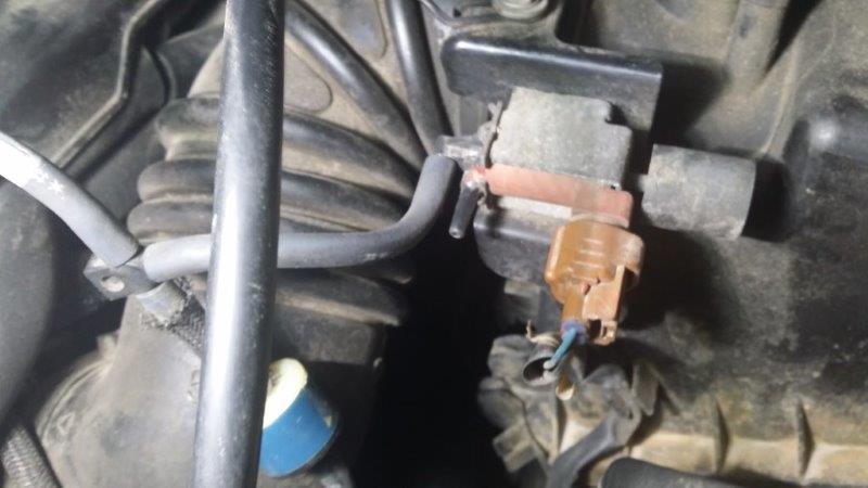

Are you missing the diagram of your vacuum routing that's underneath your hood? Should be there and tell you exactly what goes where.
That vacuum switching valve with the exposed nipple, heheh, is for the airbox flapper. I can't recall the diagram/routing offhand, though. And, it's 115am, sooo.... :oops:

ImUrOBGYN wrote:Are you missing the diagram of your vacuum routing that's underneath your hood? Should be there and tell you exactly what goes where.
Ok. So I found the hose that attaches to the exposed "nipple". It was just lying disconnected. Probably knocked out by the NTB tech looking for stuff he could charge me for last month. The "mystery" hose with the broken nipple I see connects to the back of the airbox lid. Apparently the previous owner had applied a fix that failed.
Thanks for pointing out the hose diagram that was on the hood of the VIbe. I'd never even noticed that until you mentioned it!
When I get this back together I'll be surprised if this solves the idle issue. I'll look at the idle air control next, I guess. I will say that this occurred right after I attempted to see if "lift" was still working. So I had the engine running between 6-7k rpm. If that is any clue.

Well, any unmetered air taken in by the engine will call a surge and/or uneven idle. Not to mention, will have you running a bit lean. Get it back together, drive it a bit and let us know if there are any new symptoms or if the same ones remain. It sure can't hurt it to have vacuum lines where they go! ;)
PS - When I bought my Vibe, the vacuum lines were ran incorrectly. No check engine light or anything. Thank goodness for vacuum line routing diagrams! I never see other GTs or XRSs to compare to.

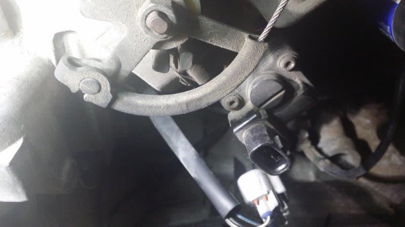

All back together and still idles at 3K+ when I start the car. If I disconnect the plug to the device just under where the throttle cable attaches then it drops to about 2.5K.

That is what I was going to look at next. Is the IACV the device I unplugged that is directly beneath where the throttle cable attaches? Know of a way to test it rather than just replace?

Today I took apart the IACV. I found It was binding inside so didn't rotate freely. Once I cleaned it up with carb cleaner it was much improved and I thought for sure that was going to be the fix. Unfortunately when I got it all back together the problem remained. I am about to throw in the towel and take it in to a dealer for them to figure it out. I guess it could still be something with the IACV like the solenoid. Anyone know how to test that? I hate to buy another just to find it isn't the issue. The RPMs do drop when I unplug it by about 500 rpm or so. Not sure if that means it is working or working incorrectly.
