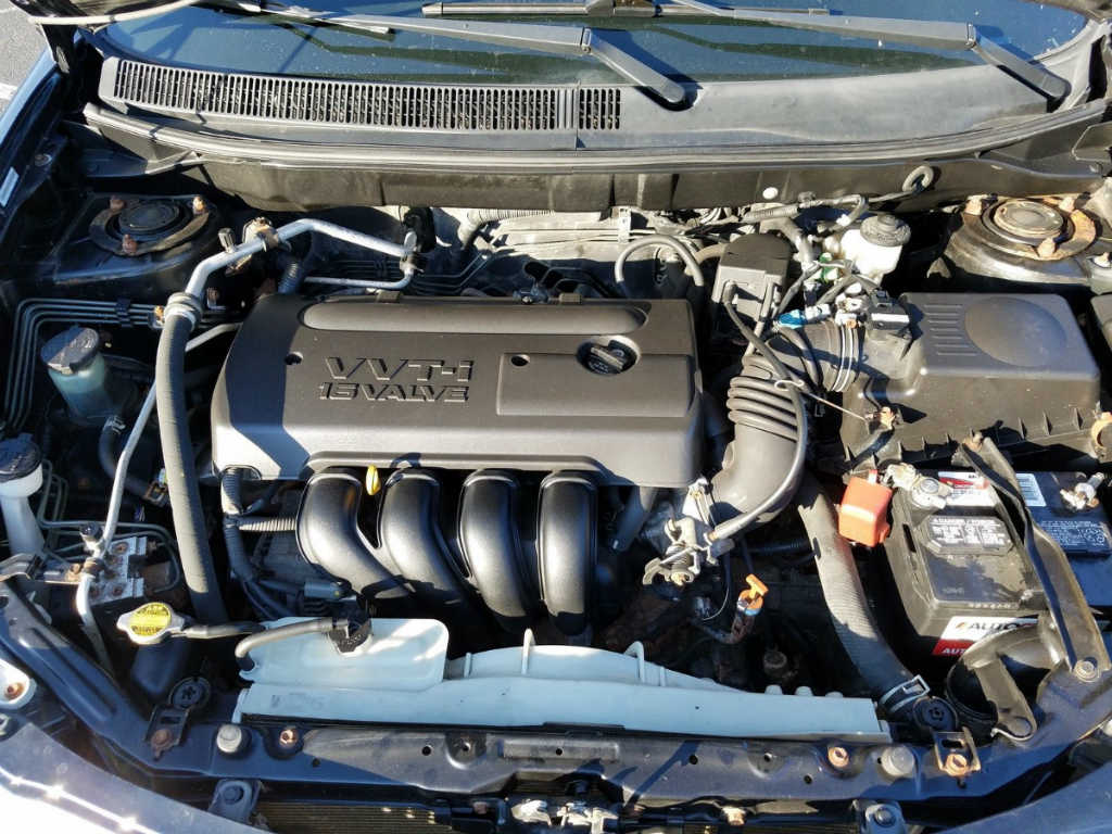

I know it's too late but if I were you, I would skip the car because first the car stayed in NY for ten years, second the picture of the engine bay already shows some rust.

Where did you get that image from? Are you suggesting that I trash the car now and part it out?
pakong
Posts: 96
Location: Richmond, VA
Re: RUST!!!
Post by pakong »
That's the image that was posted on eBay. You're right, it did spend a lot of t8kime in Rochester, NY. The rust on the undercarriage is extensive as well. This should be a warning to eBay purchasers. Good detective work in tracking down the original image from eBay.

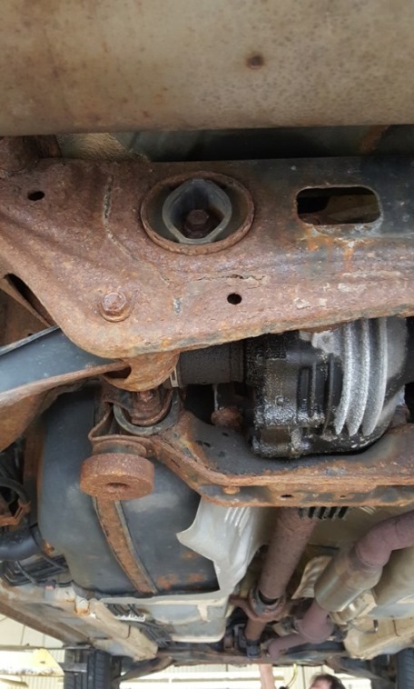

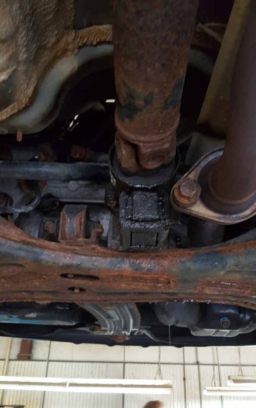

I didn't think that I could better with an AWD. I may have some remedy sine I paid for it with PayPal. I do have a lot of pictures of the undercarriage but I have 2 that I would like to post but, they won't load for some reason. I've reduced them down to 20% but they still won't load. Any suggestions?
Vibe Undercarriage1.jpg (100.51 KiB) Viewed 16143 times
Vibe Undercarriage2.jpg (99.52 KiB) Viewed 16143 times
Re: RUST!!!
See if you have recourse to the seller. Maybe PayPal can help.
My next idea would be to get a used assembly from a Southern junk yard.http://www.car-part.com/

Thanks Vibrolgist! I'm not sure what to look for in that link. On http://www.gmpartsdirect.com/auto-parts ... nsion-scat ,it looks like parts 88973231 Suspension Cross-member 88971294 Lower Control Arm, RIGHT and 88971295 Lower Control Arm. I actually took it into AAMCO to repair the transfercase leak and the pinion leak as indicated by the safety inspection.
They wouldn't touch it because they felt that if they unscrewed any of the bolts that the whole thing would break apart. So they just topped up the leaks for me and promised to top up the fluid every month. I may have another issue with moisture under the carpet both in the front and rear of the driver's side. I hate sunroofs for that reason, drain channel blockage may be the culprit. The vehicle drives well for the most part but doesn't idle as smoothly as I would like and choke is crazy at first start after hours of sitting.

Thats just enough rust in the wrong places. Removing the bolts would be hard enough, but having to knock the members loose could cause other damage.
Moisture under the carpet could be from a few other sources, blocked AC drain on passenger side, spilled beverages (the paddingacts like a sponge that almost never dries. Water that came in from the subframe, there is an open channel under the Vibe, water can get into the carpet even if it is not high enough to come over the door sill. Some have also reported that dealerships failed to install OEM plugs in the transport tie downs, this can also let water into the bottom of the vehicle.

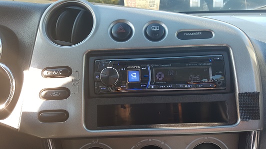

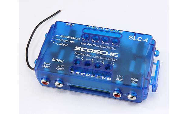

Scosche SLC4.jpeg (29.29 KiB) Viewed 16109 times
Installed Stereo.jpg (78.23 KiB) Viewed 16109 times
