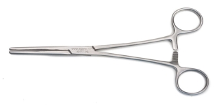

My cig lighter can short out fairly easily, so I've replaced that fuse a number of times. I use a mirror, a flashlight and a long latching surgical forceps,
can change the fuse kneeling on the ground by the open driver door, no contortionist skills required

yeah, I thought about trying the mirror/flashlight method next time as well - will have to look into getting some long nose locking forceps.
That would require leaving the fuse block cover off as well - but I guess with a little manipulation, you could unlock that as well with the forceps.
