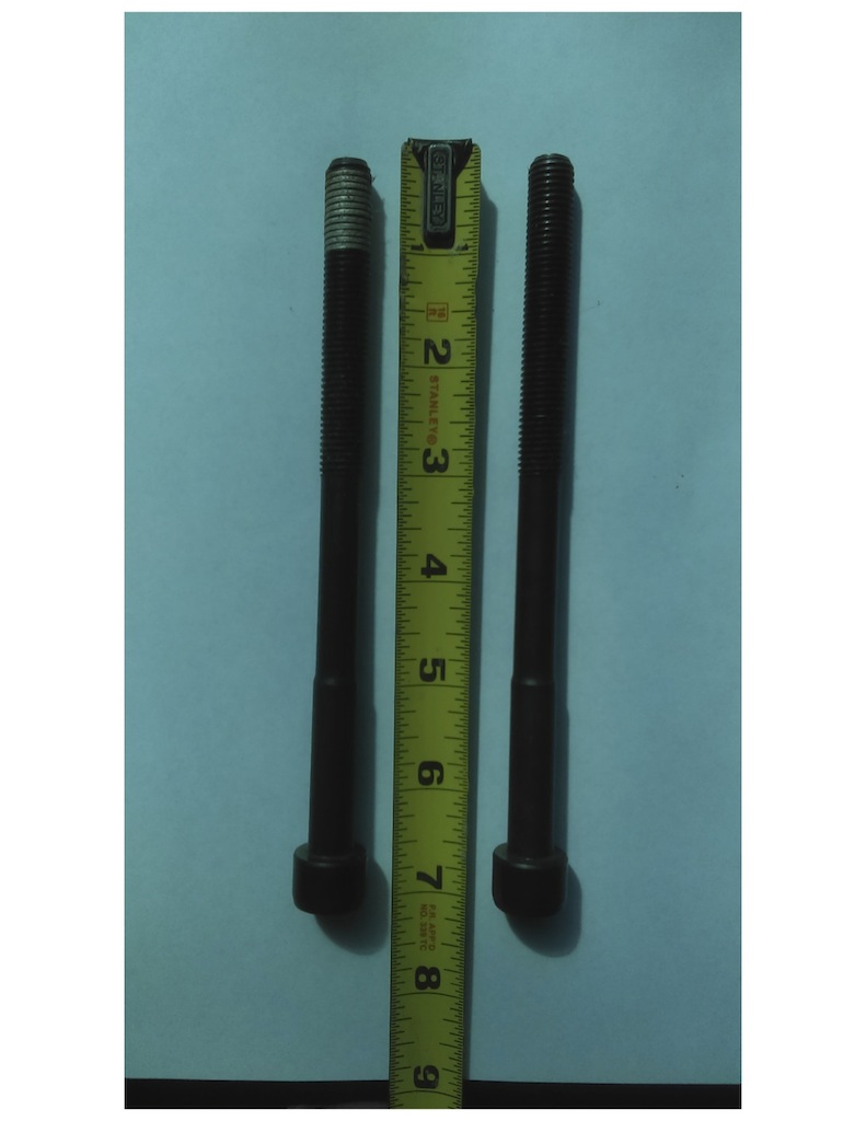

This thread is pretty old, but I wanted to post a picture of what the problem is with the 2AZ-FE head bolts.
I had a 2002 Camry that started leaking coolant out of the intake side of the engine. The car had about 163,000 miles on it and ran pretty good. I traced the leak to the insulation around the intake manifold to find out that is was the head that was leaking externally and soaking the insulation. I pulled the cams to get the head bolts and as soon as I put a wrench on the first bolt I knew there was a big problem. The bolt was loose and actually spun free in both directions. Three bolts were stripped. Thermal expansion causes the steel bolts to gradually rip themselves out of the aluminum block in this isolated spot on the block. Clearly an engineering flaw that Toyota never took care of. The fix seems to be either TimeCert (like a helicoil, but I don't think you are supposed to use helicoil in this application) or head studs like those from ARP. I used the ARP head studs. There seems to be about 5/8 " inch of good threads beyond the reach of the factory head bolt. They sucked down tight and my leak went away. For how long? good question, this fix is only as good as the original, the problem remains. This job was a huge pain in the (removed) (DONT drop anything behind, on top of, or around the valves; you'll be pulling the oil pan trying to find where it went).
So, now I have a 2009 Pontiac Vibe with the 2.4. I was worried about the same problem, but for as far as I can see there don't seem to be any complaints on the newer 2AZ-FE. fingers crossed!
The picture shows actual stripped aluminum threads from the toyota block still in on the head bolt, the other bolt (the clean one) is for reference.
