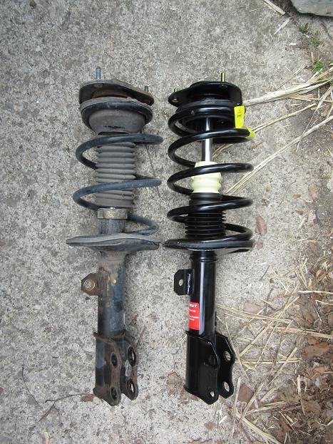

I put 4 new Monroe Quick-Struts in my Vibe. I hope for better comfort. So far there is less harshness. I used the old nuts on the front struts because the new nuts are severely ovalized. That must be the reason some folks had to deal with broken studs.

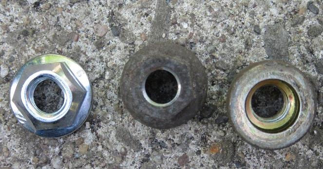

compare the new nut with the old ones. The old ones are not ovalized and have dedicated contact surface to the body.

front: old vs new
front: old vs new

Just saw this now! Change out the used nuts immediately for the new "oval nuts"! They're supposed to be that shape, they go round when you use them and they serve as locking nuts (and are one time use).
JD, I appreciate your concern. My concern is that I end up with broken studs like some have reported. They were trying to get to 28 ft-lbs and the studs popped early. Obviously, they did not go round enough. I deliberately chose to reuse the original nuts. Of course I will recheck the torque a few times. Please, don't loose any sleep over this.

No worries, just wanted you to know why they were that shape. If you're going to stick with the used ones, I would suggest red Loctite.
