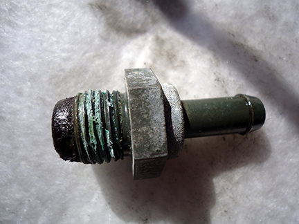

I just got my PCV Valve off my 04' base to check it out. I'm guessing it may have never been replaced (184k miles)- though I'm not sure- here's a pic:
Is this what I'm looking for to replace it with? http://www.amazon.com/Toyota-12204-2204 ... B00KTG52A8

PonchoGT
Posts: 70
Joined: Wed Apr 08, 2015 11:43 am
Location: Fort Knox, KY
Re: PCV Valve
Post by PonchoGT »
A 3/8" O2 sensor socket and a shot of PB Blaster is what I used to coax mine out.
