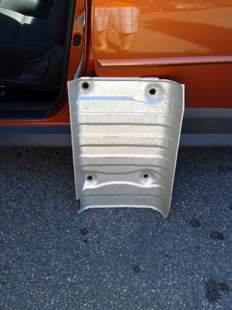

Went wilderness camping in Kelowna, BC, drove on lots of dirt roads to get to and from campsite
A rattle started at idle, hole in muffler suspected
Kept driving, rattle seemed to subside
Arrived back in Vancouver, rattle resumed
Backed out of driveway, a curved aluminum sheet fell on the pavement....
The attachment 20160502_154435 (Small).jpg is no longer available
I crawled under the car today to figure out where it came off of, whether the bolts were still attached to the car, and whether I could salvage them, add some fatass washers, and re-attach this bad boy, but wasn't really able to figure it out. Instead my findings showed a world of rust and nuts/screws that are inundated with rust all over the place, some even already cracked, which is concerning. Anyone know whether this heat shield is crucial for west coast driving and where it even sits?
Please help

The heat shield is pretty critical to protect the fuel tank and cargo from exhaust heat. Just hold the heat shield over the muffler and see if you can guess which holes are to the shield.

Thanks for that. I tried to figure it out but couldn't. Will just pay someone to fix it for me I guess

Ok, here's my 2 cents! Most of those holes are likely "drain holes" and are needed when water/ice/snow make i5t into the channeled areas. Larger holes are likely there for accessibility to a fastener or some other item needed to get to. The rust somewhat looks bad BUT if this Vibe has high mileage and driven in a lot of winters where salt/brine were used, then it's in pretty good shape. Finally when vehicles panels are stamped out during production, the same panel will be used for ALL trim levels of that vehicle. Base, GT, AWD, etc. so depending on the engine/drivetrain options, some holes will utilize additional components where they would possibly use some of those pre-punched holes in the panels.

that makes sense thanks for that . i didn't think about the water drainage explanation.

$25 bucks at the local shop to clamp it back on . bam bam done.

Hi Everyone...
I have a 2005 Vibe Base - lost the same heat shield yesterday in the rain. Picked it up off the highway. Almost hit the lady in back of me.
I had previously had the gas tank heat shield bouncing around, tied it up with zip ties like many others. I had assumed this was the same one. Nope, it's a squarish thing just like the picture above. The gas tank shield is skinnier and only goes over the portion of the exhaust that goes right by the tank.
I *assume* this goes between the muffler, and the bottom of the spare tire compartment, and deflects some heat away from the sheet metal. Doesn't seem to be anywhere near the gas tank. Anybody think this is much of a concern if I don't put this back on? Does the muffler really heat up the metal under the spare tire that much?

Mine fell off after dragging on the way to work. I picked it up the next day. It has sat on my garage shelf for two years. The car has endured summer road trips, loaded, through mountains. Didn't catch on fire.
You'll be fine without it.

Hard to tell unless someone put a temperature sensor and read the value. Just put it back if it’s not a big trouble.
Check out this video from engineering explained. At 1:50, there's about 50 degrees Celsius difference around the shielded area.
