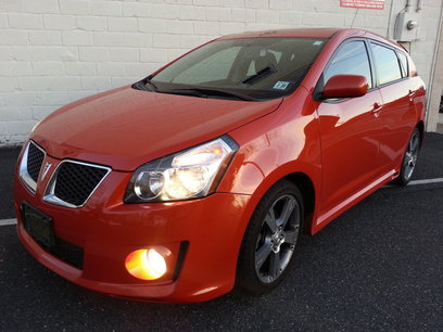

My 2010 Vibe GT has 79,000 miles. The roads in my area are pretty crappy - lots of concrete, lots of potholes and subpar fixes of those potholes! I have never been a fan of my Vibe's suspension even when it had 19,000 miles (except on brand new pavement). Now, it's even worse. I'm in the market for new suspension in any way you think will help. I have to replace tires soon anyway, so an all-around fix is very welcome. Are there specific shocks and springs with specific tires that give it a ride more like a Corolla, for example? Can you simply use Corolla or Camry parts, for example? I've seen many posts about lowering your Vibe, but not about giving it a more comfortable ride. Frankly, I'm surprised. If the roads aren't brand new, the ride and noise are pretty bad. I assumed it was a Vibe GT problem others have had.
